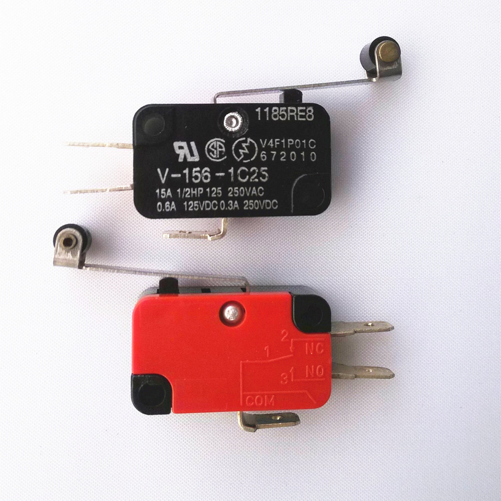

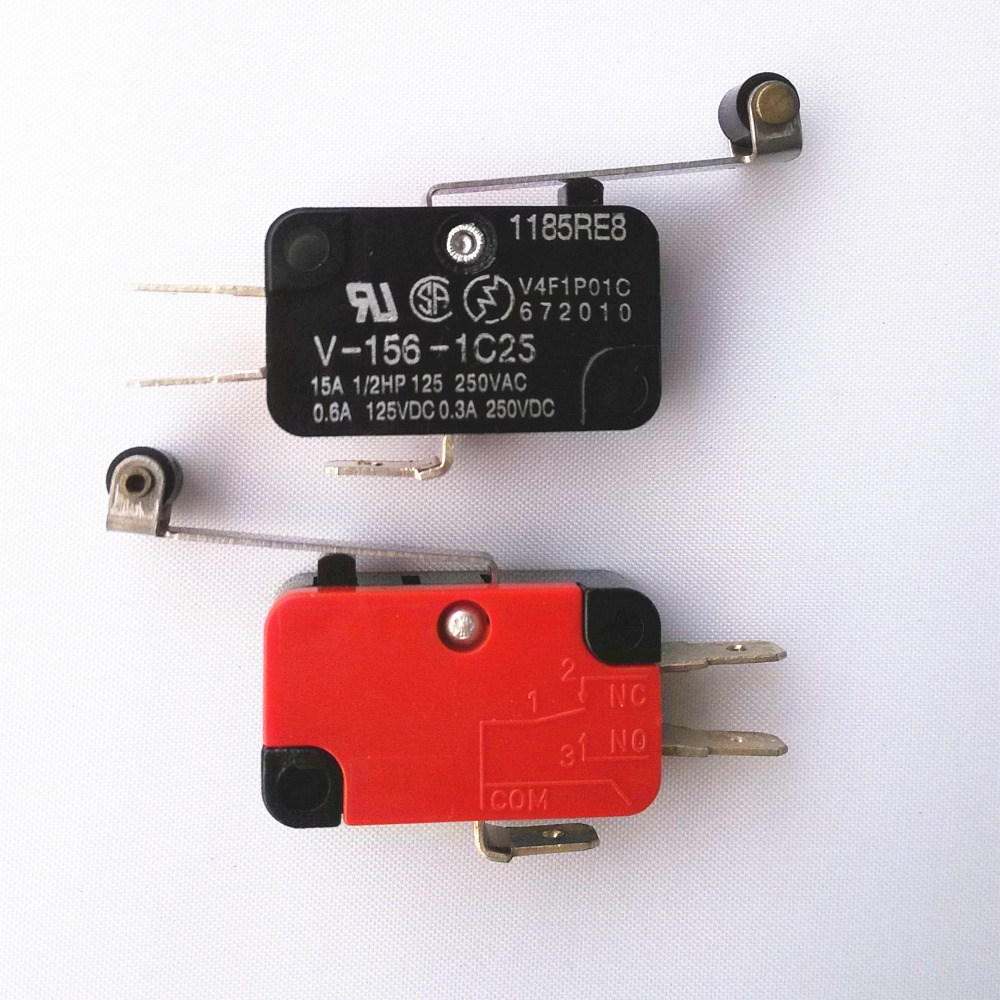

  28. chadderuski
    Feb 13, 2015
    Hi All!
    Have made a lot of good progress on the OX. I have all axis up and running and home switches for the x and y working, but I am having trouble figuring out the best way to install the z-axis homing switch.
    My switch is the omron (see attached).
    Suggestions?
  29. Neptunes Guitars
    Apr 5, 2015
    Hi mate have a look at the Stainless Steel Ox by Martin that's how mounted my Z switch albeit I bolted mine on. I elongated one hole to allow for adjustment up and down to fine tune it.
    Good luck chadderuski
    Cheers,
    Peter
  30. Florian Bauereisen
    Florian Bauereisen Well-Known
    Feb 24, 2014
    188
    60
    Hi,
    @chadderuski
    try to source the (same-) kind of switches with shorter arms...
    The lesser lever will give you better accuracy. Think of it.
    I think mine are from omron too..
    greets
