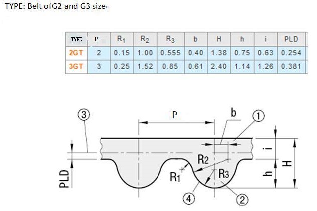

    What I don't get now is how the kit seller I bought from said the GT3 belt/pulleys were "better" than GT2, but from attached image (also somewhere else on this thread),
    the GT2 have better accuracy....????
    Should I switch to GT2's ??

    Is gt3 not the exact same as Gt2, but just called gt3 on the Obuilds store since it has a 3mm pitch? It makes 0 sense to me that a 2mm thick belt would be less accurate then a 1mm belt of the same material.

    The GT3 belt is about twice as thick as GT2 (see graphic) and according to the videos the reason they recommend using is because it's stronger. I just got my OX up and running and I'm pretty new to this so I don't have a lot of experience how well it holds up and I can't attest to accuracy but so far everything I've cut has been dead on. I think it depends a lot on what your cutting and how accurate you need it to be. I eventually want to convert my X and Y to lead screw that in my opinion would be a lot more accurate than any belt.

    Being thicker, GT3 belt has less stretch. As it also has a deeper profile, it is less likely to jump teeth on the pulley.

    Yep, you're right. I did a lot more reading and although the GT2 belts are about 4 time more accurate they lack the torque ability of the GT3 belts.
