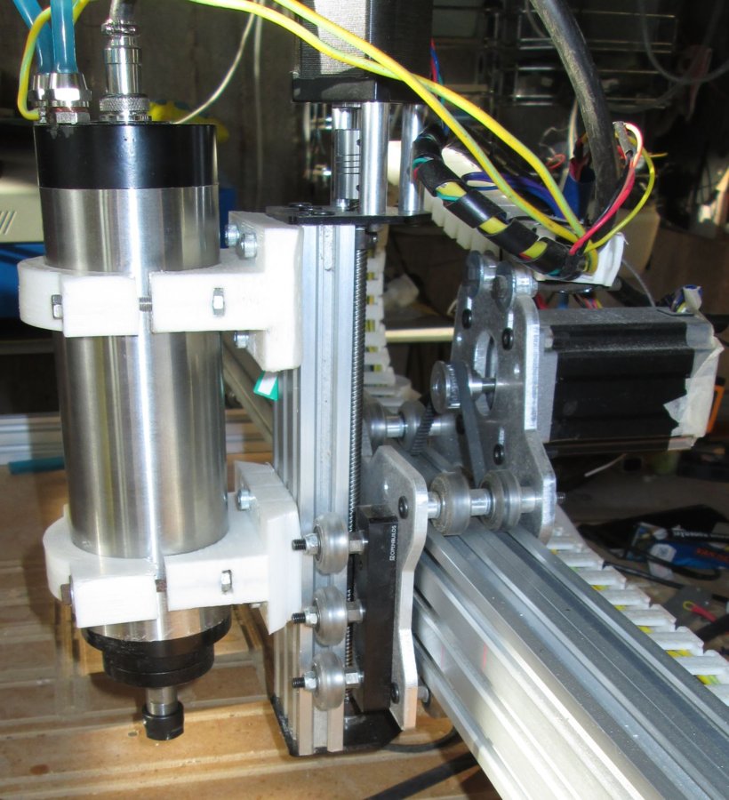

    i am having the ox and also a minimill right now. minimill is for cutting bronze and some other non ferous metals and the ox has been purchased for cutting wood . believe me wood is more difficult material than almost any metal. on the metals you can go slow and slower add cooling and cut it . on the wood there is no cooling option and also wood doesn't like slow at all so you have to be strong to be fast.
    The perfect solution would be a cbeam ox machine but this is a different budget. I would say talk to the openbuilders and get one ready for buildnig with all the upgrades.
    At this time my ox runs with a 10x3 leadscrew on xAxis and a printed ( abs ) nut . during the next month i hope i ll replace the y axis belts and then the structural part will take place with heat treated steel as a reniforcement material.
    so in my opinion you cant have them all at one. if you want strength go smaller. otherwise you ll end up like me which i wanted all and took from the three the longest one :rolleyes:( sorry it is a saying here). the 1x1 meter sound better although i would prefer something even smaller.

    hello i`am looking to get a water cooled spindle like yours how is the weight and can u do a video of it working i have the ox build i was told the weight of that spindle would be to heavy iam useing nema 23 motor ///
  24. Gaou²
    Gaou² New
    Nov 17, 2014
    20
    it is a little heavy for that build but if you have a 23 stepper that wouldn't be a problem. i am using a nema 17 and it cant keep the weight of the 1.5kw water spindle i am using.
