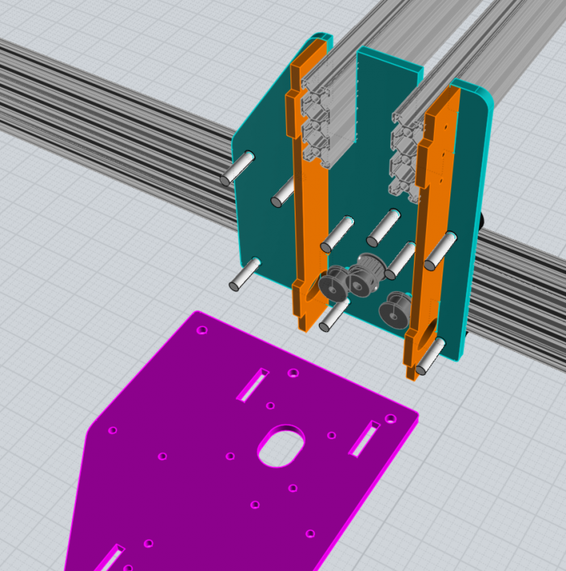

    I'm working on an MDF version of the OX. MDF has great dimensional stability but on a small scale it lacks the hardness of Aluminum, Steel and Garolite. Forces on the parts will cause the holes to deform which results in sloppy linear motion over time. To make up for this in the design, I'm going to pass all of the 'axles' for the V-Wheels through a torsion box structure. This gives them two support points at least 20mm apart. It will act as if the the part was a 1" thick solid block of MDF but it will be made from 1/4" MDF sheets you can get at Home Depot and cut on a 50W laser. The belts will all run outside the aluminum rail so it will be possible to use 9mm x 3mm GT3 belts. The X rails are secured to the vertical torsion box members as well as the outside plate. They are spaced further apart than in the OX design so that the V-Wheels contact centers form a square when viewed from the side. I'm also planning for a taller Z and spaced the Z wheels out further. These two changes combined should give us a very rigid Z-axis.
    I'm still finishing up the X/Z axis core. I realize that there needs to be some play to align the X rails to be parallel and match the final width of carriage. Making something thats rigid, long lasting, easy to assemble and easy to adjust (you have to reach all of those eccentric spacers!) is a difficult challenge in wood. But its fun to try :thumbsup:

    Interesting approach Gareth and it certainly looks promising. I look forward to seeing the finished result.

    @Gareth Nice looking design, looks like its going to be a very strong machine. Looking forward to your build :thumbsup:

    A friend of mine built a cnc with MDF and had issues with the wood chipping/wearing at the wheel bolts so he cut new parts and sprayed them with a hard laqur finish to harden.
    He said it worked for him, maybe something you might want to try

    Gareth- Sounds like a great idea. I had an idea a while back of stacking laser cut thin plywood to create a part. If you have a laser you could cut several layers of say baltic birch plywood instead of mdf. If you are worried about the wheel shafts deforming the mdf you could add bronze bearings or even drill bushings. I don't know how long you want it to last long enough to mill out some better ones. I use baltic birch a lot for jigs and fixtures. It is hard and stable and relatively easy to find. You can often find it very thin that is used in making model airplanes. Keep us posted with how you make out. Best Bill

    One other question around tolerances. The standard v-slot build plates have clearance between wheel holes of v-slot thickness + 20.64. The OX plates had 1-2 millimeters additional. Was this intentional or just sketch up inaccuracies? I'm in the middle of converting the drawings into another cad system which support arcs / circles and can push back up some DXF without the sketch up off by partial millimeters problems.

    @JustinTime Sketch up does not (at least last time I used it) handle circles as arcs. Cut a hole in something and it's immediately a set of line segments and when exporting it converts arcs to line segments as well. This can be seen in Mark's DXF files. This leads to several small inaccuracies in the resulting files and potential problems with CAM / machining if you have to many segments per arc.
    I'd highly recommend anyone using sketch up for mechanical parts look at Autodesk Fusion 360. It has parametric features more suited to designing things like this and has a free hobby license level and built in community design features. SketchUp is free as in beer, but not open source so there is not really a philosophical reason to stay with it.
    I was not referring to bit size, but type as for these plates you have to use 1/8th cutter since M5 holes < 6.35mm. Machining 6061 is it best with a straight flute, o-flute, downcut, uncut, etc… Any recommended or avoided coatings.

    I used MArk's drawings as reference in my CAD program but I replaced all the holes with real circles...
    Ill have to check out Autodesk Fusion 360.
    My current favorite parametrics CAD tool is Moment of Inspiration: http://moi3d.com/
    Made by the same dude that wrote Rhino. Outputs to OpenNURBS format and STL.

    then it is time you upgraded both Sketchup (at least to 8) and SketchuCam (1.1b) because both most definitely DO produce true arcs. You cannot see the arcs in Sketchup because it draws them at straight lines, but the Gcode will contain G03/G02 commands for the arc segments
    IF!
    you have not exploded or edited the arcs in such a way that makes Sketchup think they are lines segments.
    DXF files can be a real export/import problem and I'm never surprised when something goes wacky in them ;)
    in particular arcs getting converted to polygonals.
