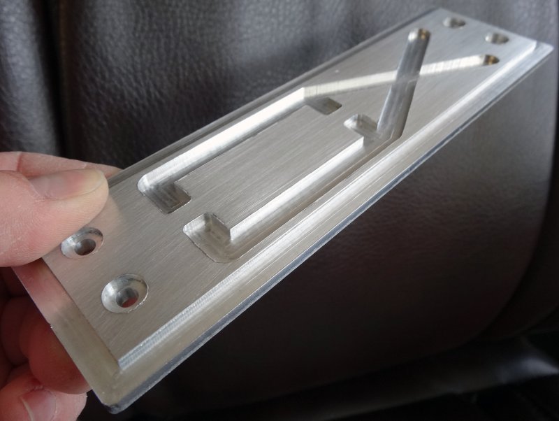

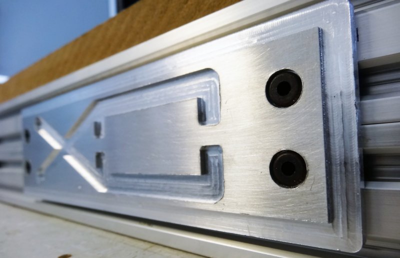

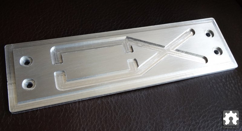

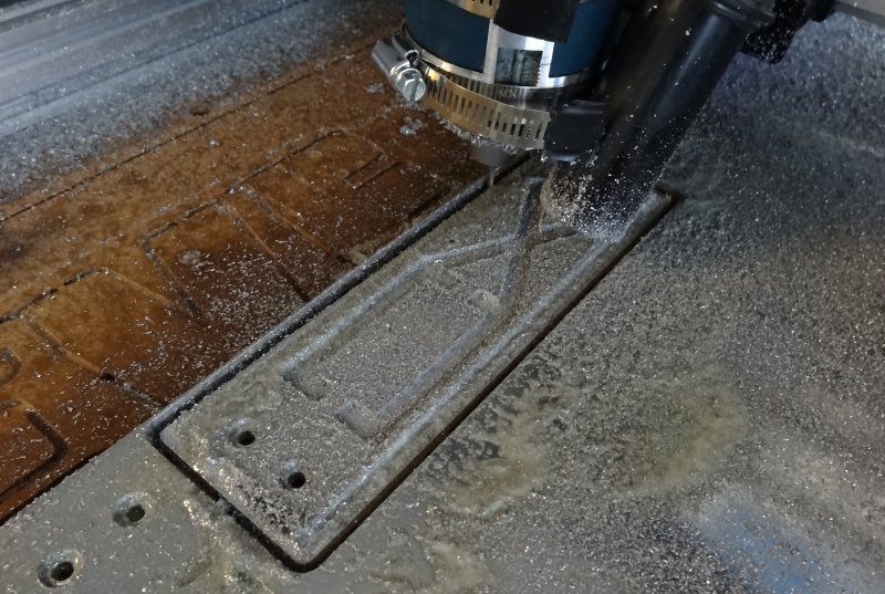

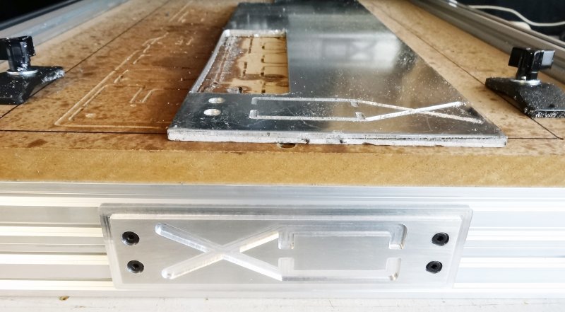

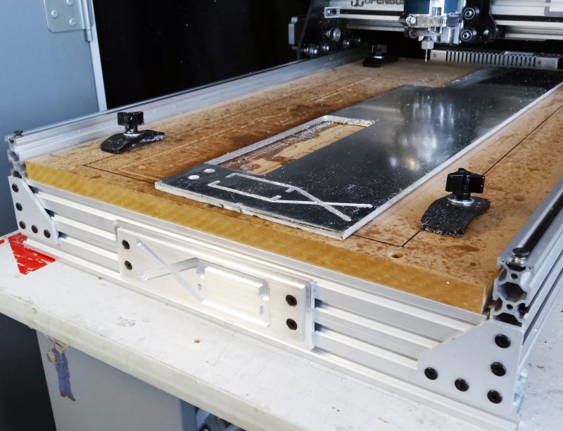

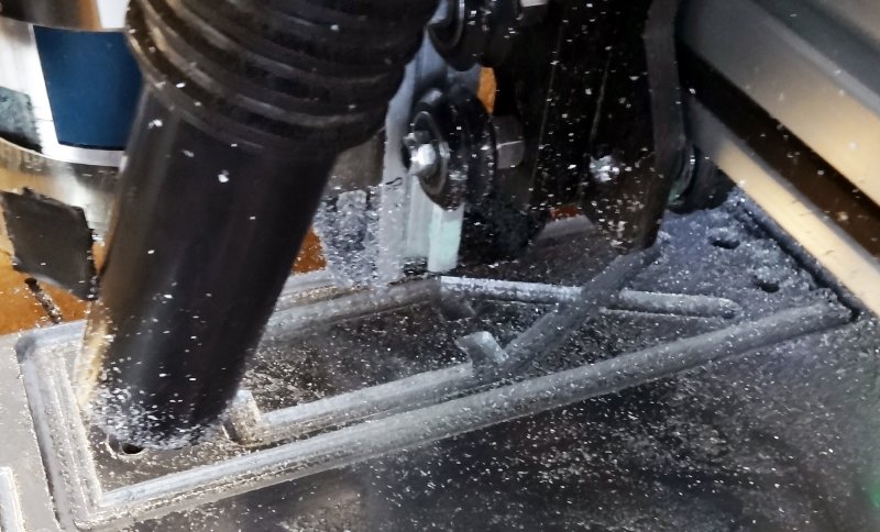

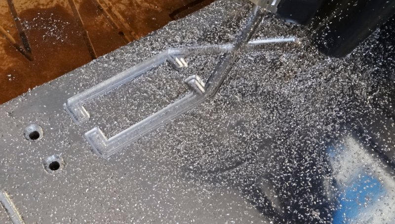

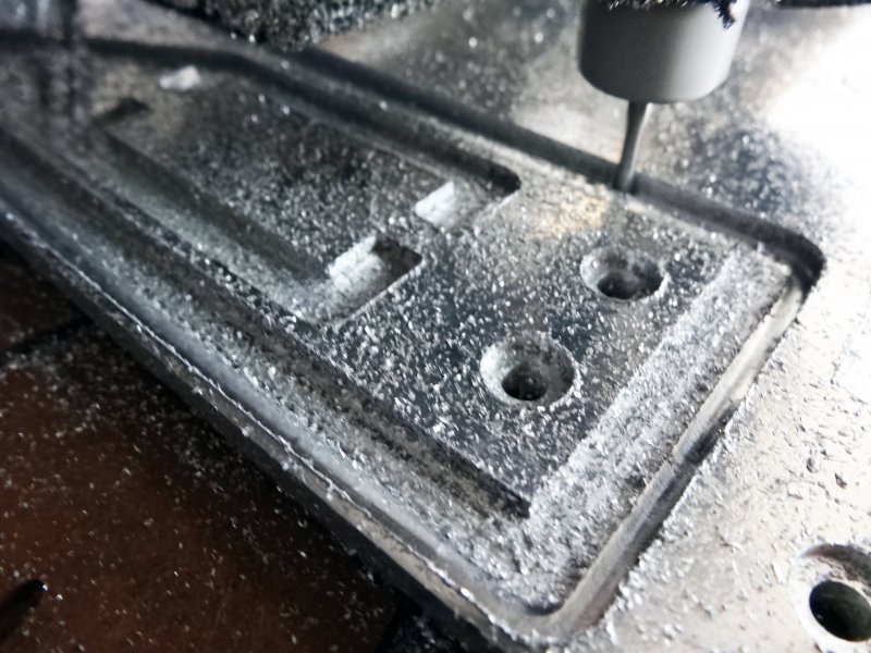

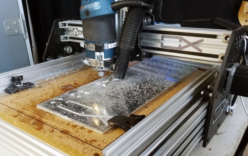

  8. Mark Carew
    2,785
    2,504
    OX makes its first cuts in aluminum and its looking great! :D
    With the OX being a belt driven machine I was surprised to see it how well it worked but circles are close to being round and it did the job with out a hitch.
    I used cutting oil (tapping) thats what I had on hand, I would have ran for the cooking oil but I was mesmerized on the cutting :D
    I used @Robert Hummel settings on the Name file of his OX AI build. 10 inches per minute with 1/64 step down. I can't remember looking at the time but I believe it was about 30 to 45 min cut. Mad props go out to Robert for all the help in getting me cutting aluminum. I had never tried it before and he showed me the ropes and sent me the proper bit :) Thanks bro you rock!
    Couple things to note;
    The GRBL shield does not keep the motors powered once the code is not being sent to the board so you have to keep an eye on the Z axis if your acme has a hi lead pitch. Once the motors are no longer getting commands they are unlocked and that means the Z axis can lower just from the vibration of the router being on in some cases. There is a way to get it to lock in the firmware and we need to find it.
    Chips, every where! You need to put up a couple strips of plastic or poster board or any shield materiel on the sides (inside) to keep the chips from filling up the belt track and coating the wheels. This becomes a quick realization about 5 seconds into the cut :)
    A vacuum attachment is a must.
    Your spoiler board will get oil on it, this is just a heads up really. It has to happen and its no big deal.
    So before getting to cutting any aluminum I would strongly suggest to make the side shields and the vacuum attachment you will not regret the time spent to make them.
    p.s. I know.. I know the plate is mounted backwards (I was in a hurry to get it mounted) :rolleyes:
    This proves that once you have an OX you can make more for friends and family by cutting out plate sets for them :thumbsup:
    On thing I need to figure out now is finishing of aluminum parts like this since this is my first cut. For the moment I just used a toothbrush with soap to clean out the chips when it was done. But there is a little 'rim' along the edges that needs to be knocked down. I was going to try a quick wet sanding for that a little later on.
    Some eye-candy.

    What's the proper bit?

    As for the motor problem I did a hardware fix by keeping a constant 5v on the enable pins of the driver boards.
    Have always wired that way so never ran into that issue and it may be that the sheild is turning the enable on and off.
    A simple setting in the firmware to keep this pin high "5vdc" should fix your problem ;)

    For cleean up a flat surface, sanding block, wet sandpaper "800 grit" and dish soap.
    Light handed sanding in 1 direction and for the edge simply bend off and sand on a agle if you want to keep the tool marks ;)

    It's easier to post pics :)
  13. Mark Carew
    2,785
    2,504
    Thanks Robert I had intentions on posting that bit picture :D

    A little side note that I should have said was wax paper is your best friend to save the MDF but the oil should only leave a stain as I have not had expansion issue, just my exp some may have diff results
