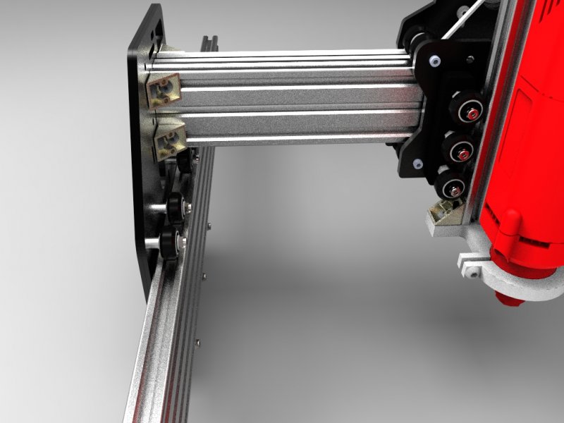

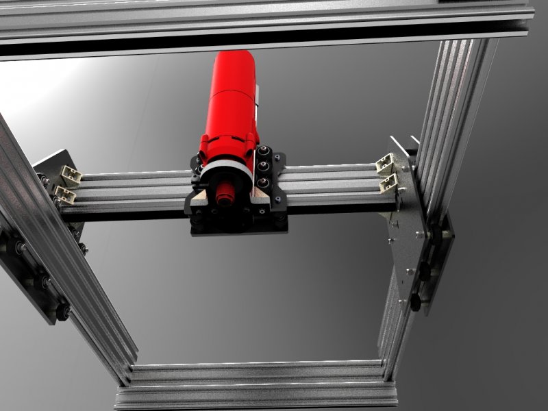

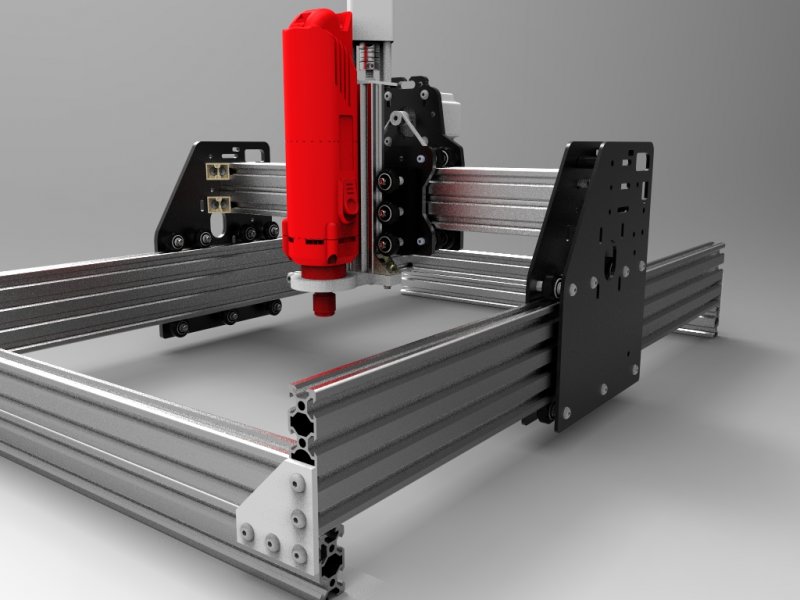

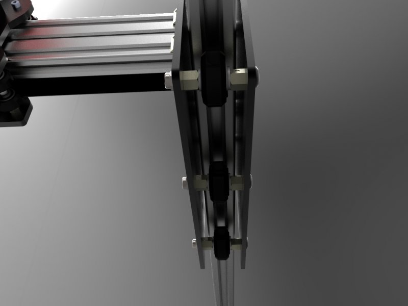

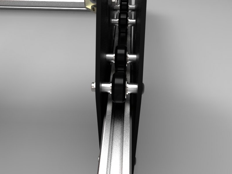

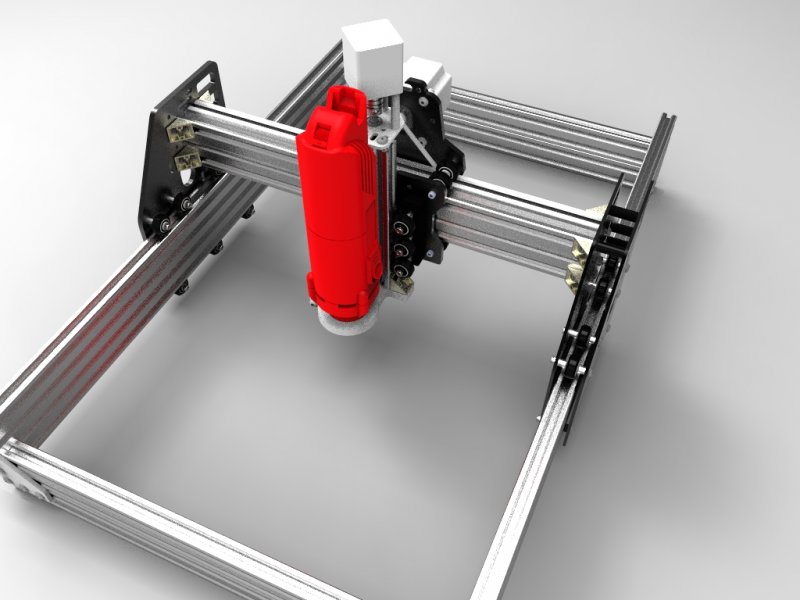

    Here are some pictures, one side shows double 3mm plates, the other the split plate design. My reference to the mild steel being heavy was meant in comparison to aluminium. A double plate weighs 1.6Kg, perhaps somebody else could state what the weight of a 6mm aluminium plate is to compare the two different materials?
    I don't think there is much chance of deformity, especially using the solid v-wheels.

    The 6mm Aluminium plates I have weighs ~568g each.

    @Colin Russon The double plate mod! :thumbsup: Looks like its very strong and will help to keep debris out of the wheels and pulleys.
