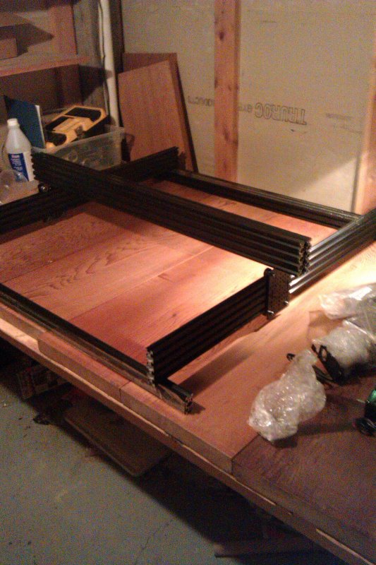

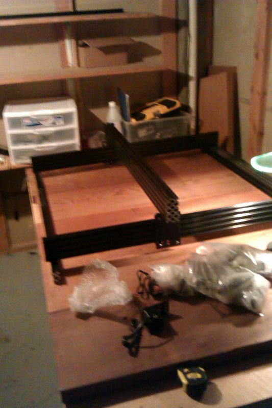

  5. alex bombay
    alex bombay Advanced Builder
    Dec 23, 2013
    I'm building a 1m by 1m Routy-OX hybrid all in black I'm just waiting on some more vslot and bolts.
    ->By the way the parts list for the routy says 3m bolts so I now have 5 bags of useless bolts :mad:

    That looks great @alex bombay !

  9. alex bombay
    Dec 23, 2013
    5m X 10 mm, also you will need 8, 5m X 40mm for the Z spacers and the X axis
    ->I'm on my 7th order trying to find all the missing or out of stock parts so expect to be short some parts.
