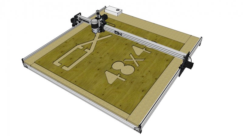

    Hello,
    Can an Ox be made with 1500mm beams to get a cutting volume of around 48x48"?
    Would the 2 x 20x60mm beams 1500mm long be strong enough across the X axis?
    I would most likely use the aluminum end plates for this.
    I've been playing around with the Sketchup model of the larger Ox with 1000mm x 1500mm beams, similar to the Ox MAX...
    Thanks!

    Sure I can't see why not. That could work and would be a cool machine. You could always bolt 3 of the 20x60 together to get and stronger beam if need be.

    What do you think of this?
    The 2 x 20x60mm gantry beams are the widest at 1500mm so I don't have to cut them.
    I may try to squeeze 3 x 20x60mm beams together, with triple-rail wheels on some much longer bolts...
    Edit: Updated with more supports underneath, and 48" wide spoiler board insert.

    @Giuliano M Nice looking machine!
    I would think you could get away with the double wheel sets on the outside beams, because the beam is there more to keep the rigidity over the long span, but hey more wheels means better alignments and over all strength so thats a good thing too.

    Thanks!
    I priced out a parts list based on your list here, and the total was about $1100 - everything except for the router.
    This will probably take me a few months to buy, so I'll make my own "Build" to track it.
