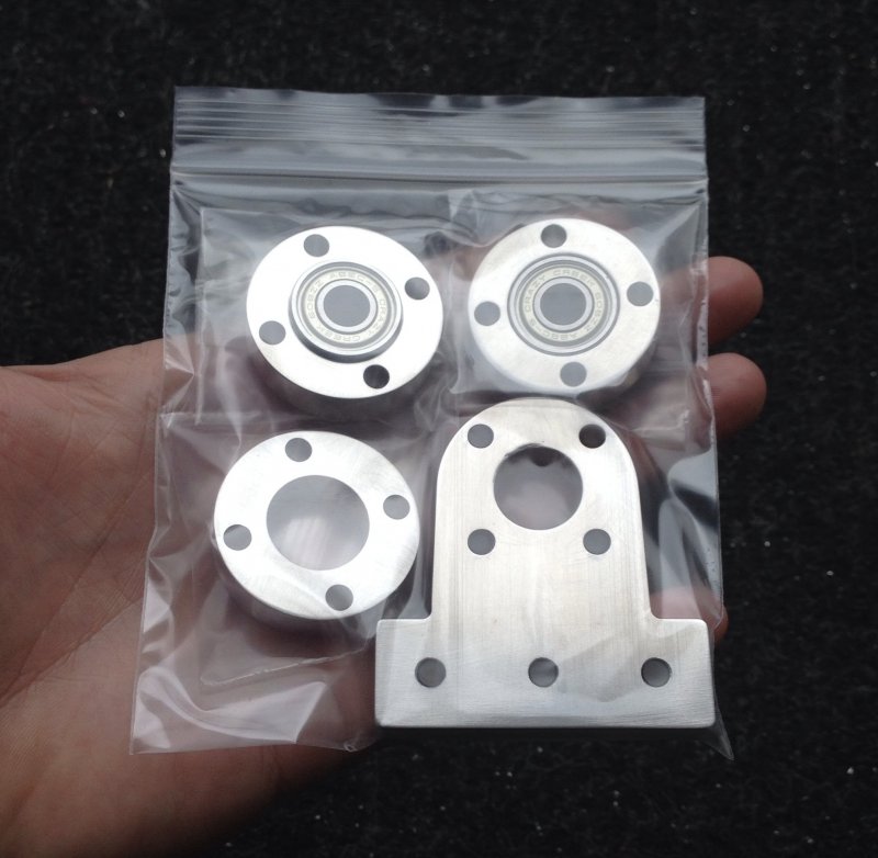

  8. Robert Hummel
    Robert Hummel Custom Builder
    Moderator
    Nov 14, 2013
    978
    718
    @Jestah
    All done!
    I have press fit the 608 zz bearings in place for you :)
    Needed to complete
    4 x 45mm M4 screws
    5045 900KV RC motor
    80 amp ESC
    ER11 100mm C8 collet
    What ever collet inserts you plan to use, I only use 1/8 and 1/4 inch myself ;)
    You can prob find a motor ESC combo for a good deal on eBay and the collet shouldn't be more then $16 on eBay
    Be sure the motors shaft is 8mm when buying your motor as everything slides onto the 8mm collet see the OX RC spindle build for details :)
    bhalkett and Jestah like this.

    Do you mill all these aluminum parts with the rc spindle? I've had my eye on your design for awhile
  20. Robert Hummel
    Moderator
    Nov 14, 2013
    978
    718
    No what you see in the pic is what I ship.
    The end user will need to get an RC 5045 with 8mm shaft, ER11 collet 100mm long, 80 amp ESC and 4 x M4 x 45mm screws.
    Then it's just a matter of assembly like in the build log.
