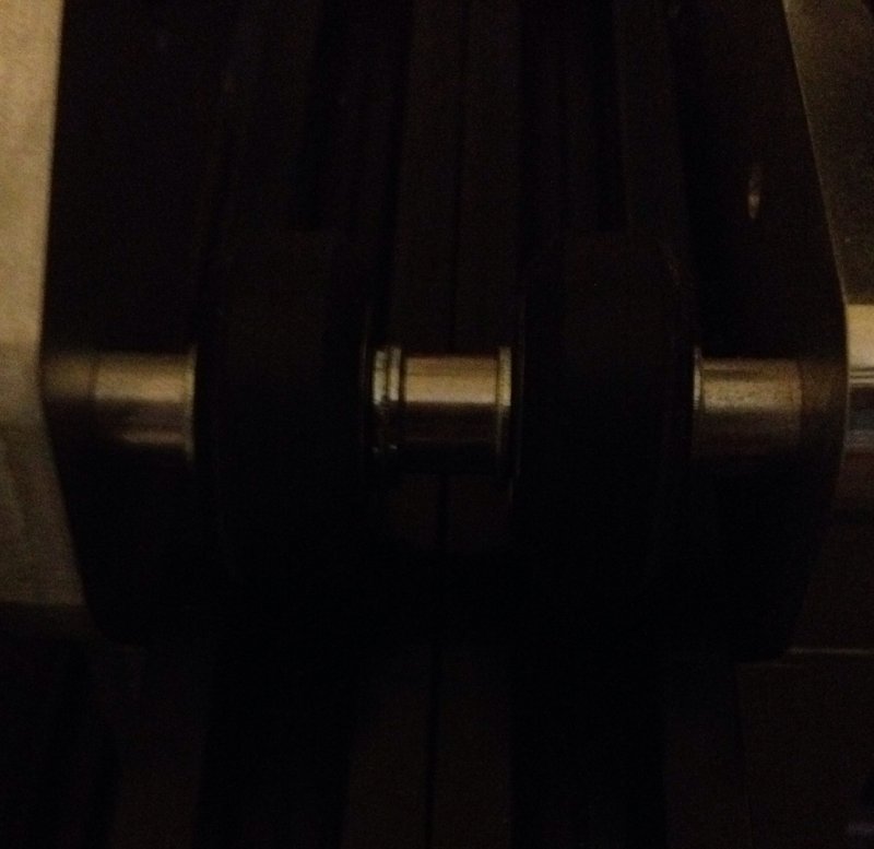

    This is what works for me
    1/4 spacer, 5mm washer, wheel, 2 x 5mm washers, 1/4 spacer, 5mm washer, wheel, 5mm washer, 1/4 spacer

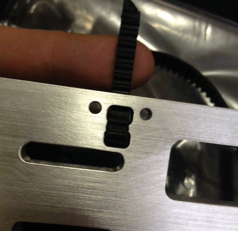

    Robert, do you offer your belt "clip" aluminum pieces for sale? If So how can I buy a few of those from you? I tried to Private message you on here but I never got a response. Thanks!
  4. Robert Hummel
    Robert Hummel Custom Builder
    Moderator
    Nov 14, 2013
    978
    718
    What plates do you have ?
    If they are anything other then mine you will have to modify your plates for the clip to work in any way and it still wouldn't be used in the manor intended.

  6. chip_breakin
    May 9, 2014
    13
    I copied your design from your "end plates" and also ported it over to my gantry plates. I'm machining some custom plates that give me an offset and raise my gantry a bit.
    I'm sure I could pick up some 3mm or 4mm 6061 and machine them but if you have some that I can buy off of you that would be great.
    It's a super cool design by the way!
  7. Robert Hummel
    Moderator
    Nov 14, 2013
    978
    718
    Oh! Ok now it's clicking
    I will mill a set fast for ya how many do you need?

    Yes six and yes to the belts, I have not milled anything but do like it :)
    Here I was test fitting it and I think it's 5 mm wide it purchased from openbuilds "special ordered belt"

    The opening in the "clips" and in the plates seems to be just under 7mm correct? I am pretty sure that should clear the 6mm width gt3 belting, I hope!

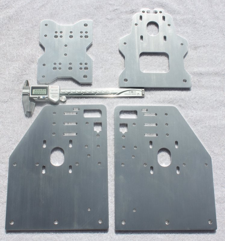

    So many receiving issues! No wonder your stomach is acting up. I hope you feel better soon! I hope you had no problem receiving my 4 gantry plates.

    It is 6.78mm wide and 4.85 high ;) plenty of room
