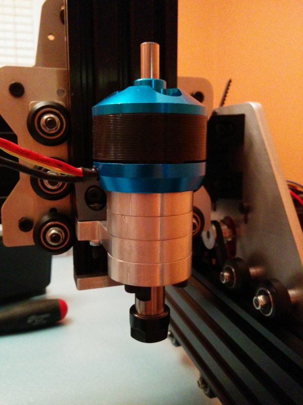

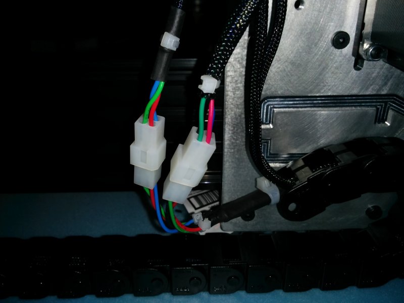

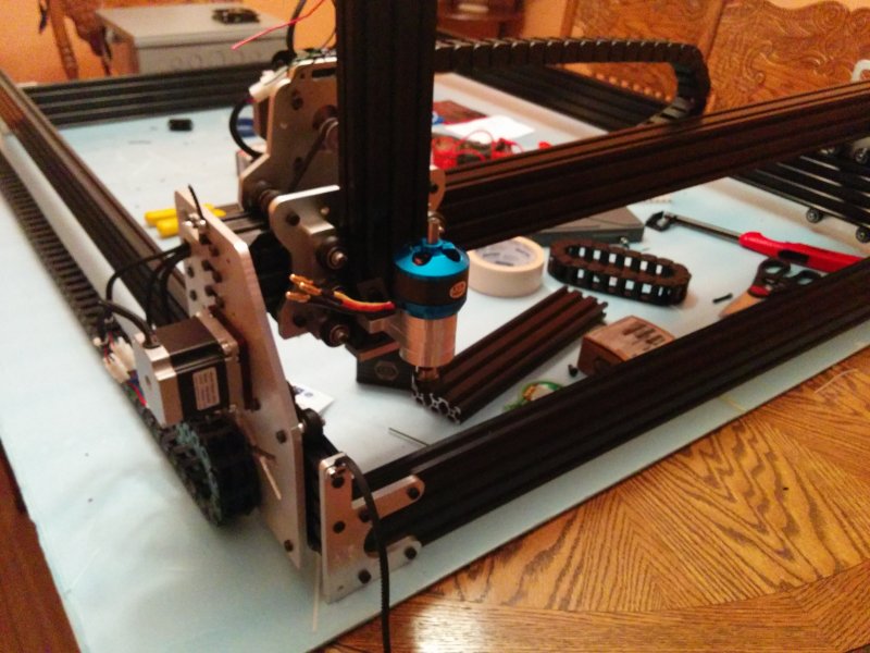

    Mine is finally alive and kicking. I'm still finalizing all the working wiring and the electronics box, but it was moving today.
    I'm being super picky about the wiring. I bought the correct color wires to match the stepper, 2x2 molex connector parts, braided cable sheath, cable chain. The whole nine yards.
    I also built a BLDC spindle based on the parts from Robert and it rocks. Once I get the PWM signal from the TinyG worked out to control the spindle I'll be happy.
    I also have to find a good way to mount the stops.
    Overall I'm super excited.

    Nice work, all the extras and fine details will save a ton of head scratching.
    We'll done !
