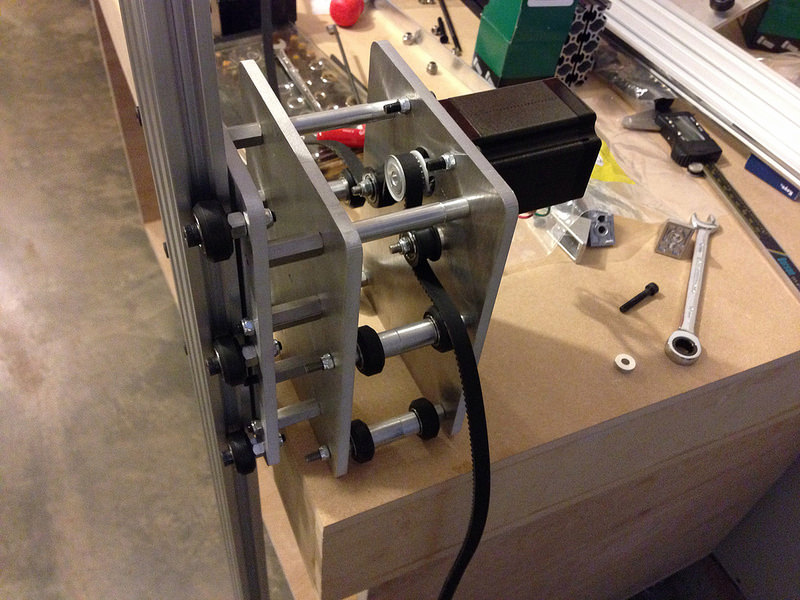

  23. Gareth
    Gareth New
    Jan 23, 2014
    15
    I've been lurking here a while and my machine is coming along. I really need to start a build on it as the design has changed a bit from the OX. It still shares the same basic setup for linear motion, same number of wheels and same configuration. I'm finally at the point where I can do some assembly and verify the design. Its really been a fun project, lots to learn and lots of problems to solve.
    This is the X/Z cart:
    When I did the CAD drawings I put the holes for the eccentric spacers centered on where holes would be if there were no eccentrics. So in theory I'd get 1/2 the adjustment toward the rail and 1/2 away. I didn't really know what to expect and wasn't sure how to measure so I went off the CAD drawings provided by OpenBuilds.
    What I found is that the two rails I have are slightly different heights. One is nearly spot on 60mm tall, give or take 0.05mm over its length. The other is about 59.6mm tall on average. Unfortunately that 0.4mm difference is enough to put the part just out of the range of adjustment on my eccentrics. So if you are designing your own plates you want to err on the side of more adjustment towards the rail (3/4 should do it). I'll be making the adjustments to my plans before I release them. If you have one rail that doesn't seem to play nice, try putting some calipers to it and see if its smaller than the others.
    The 80x20 mm sticks I have are black anodized and both are spot on 80mm (+/-0.05mm). I've ordered some more 60x20 mm in black to see if I can get a piece thats closer to true dimension. A $25 piece of rail is cheaper than throwing $200 worth of custom water jet cut Alu in the recycling bin.
    I haven't tried any of this yet for myself so you can take this with a big bag of salt:
    On the subject of the z-axis: I'm using 4 start 3/8" ACME rod and parts from Dumpster CNC. This is fast rod, 1 turn = 12.7mm of travel. Thats faster than the 8mm rod in the parts store. At 200 steps the smallest height increment is 0.0635mm. If your want to carve 3D stuff them you probably want a Z axis that can match the speed of the other axes, otherwise that will limit the overall speed of the machine. If you are going to use the machine like a mill, for flat stuff, then Z speed is not really a consideration. The 20 tooth pulley in the parts store has a pitch diameter of 19.10mm. So the smallest increment you can resolve on the X and Y axes is ~0.1mm. So the pulleys are still around 2x 'faster' than either rod.
    Configure your machine for the jobs you want it to do, thats the beauty of DIY machines.
  24. Tweakie

  25. gwandad
    gwandad Well-Known
    May 12, 2014
    69
    55
    This is more a query than any thing else.but using a z axis that fast will certainly be a bigger problem than the 8mm I'm using, so how do you support the router? I can set, via tgFX, the Power Management to have the "motor on active", or "power always on". Question: Is having the power always on a problem? I have zero experience here, but if it is not a problem, then the speed of the Acme rod doesn't really matter & I've been chasing a "red herring".
  26. Gareth
    Gareth New
    Jan 23, 2014
    15
    I had assumed motors were always on even on the X and Y axes. Is this not a valid assumption? X/Y don't have much holding them back other than the stepper. A spinning tool bit should be able to move the Y axis without the stepper holding it.
    I don't know how I will handle turning the power off when shutting down the machine. Maybe I will have to use some kind of physical axis lock or something.
