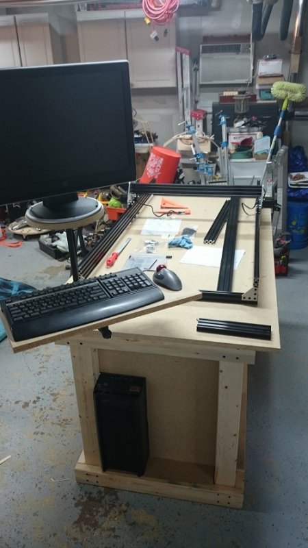

  12. Rich C
    Rich C New
    Aug 4, 2014
    66
    Ok, so question on the electronics if I may.....
    I am just about ready to start getting the electronics portion of my OX going... I bought the gshield and the Seeduino v4 blue that was identified in the BOM. The boards I ordered (I had to order from different locations) did not come with any preinstalled software. I bought BOBCAM-CAD v26 PRO software and will have that running on the tower computer. So here are my questions:
    1) what software will I need (and where can I get it - preferably already configured for the most part) for the gshield
    2) what software will I need (and where can I get it - preferably already configured for the most part) for the Seeduino v4
    This was taken a few days ago..I have since painted the table top, attached the gantry and z-axis. Still awaiting a few parts from OpenBuilds and casters (please disregard the garage mess) DSC_0061resize.jpg
    I will upload a newer pic once I pull the photos from my phone....

  20. Rich C
    Rich C New
    Aug 4, 2014
    66
    Thanks. here are two more pics. One shows the painted top and the Makita RT0701C mounted, the other is a side/rear shot showing my printed cable-chain and v-slot wire-holders. There will be another cable-chain (which I am currently printing) along the x-axis that will sit atop the silver v-slot. I will have to remove the power cord from the Makita and run it thru the cable-chain because the plug is too large to fit thru the slots. Oh, and the OX will be bolted to the table top.
    One point of note: you notice (or maybe not) that the silver v-slot is only being held with one screw on each end, that is because if I rotate it 180 degrees, the nuts behind the rear z-plate actually set into the v-slot and I didn't like that idea. There isn't going to be any weight on the solver v-slot, so I figured the single screw on each end would suffice (and it is the perfect width for my cable-chain in the orientation that it is in). Also, the red brackets around the NEMA23s may or may not stay....they might be used to attach the cable-chain ends, but I am looking at another option...
    I have 40 feet of stepper motor wire on its way, once that gets here, I will start my wiring task.

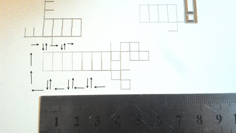

    I did the same exercise. I took pictures that I magnified and printed. My backlash on the X axis seems to be 0.333 mm and 0.188 on the Y axis.
    What could we do to improve this? This is a standard build with GT3 belts.
    Frederic
    Jeferson SImoes likes this.

    I was thinking it was some my mistake. I realized that different micro-stepping change the backlash. 1/32 and 1/16 I get about 0,2mm or more. Now, with 1/8, the max backlash I can mensure is 0.13mm.
    Here's a table about the belts backlash: http://www.sdp-si.com/resources/imgs/belts/fig10.jpg
    I will try a reduction system in next weeks and report here about. I don't want to use Mach3. It's the cost of software + PC with DB25. Or "high" cost of a solution to use Mach3 in USB computers. I think the GRBL + some mechanics solution will be cheaper.
    I mean (sorry my english, guys):
    Money to get Mach3 + breakout usb board + belts setup = Arduino + ballscrew setup.
    Even the ballscrew solution would be more expensive, I prefer improve this backlash in mechanics, and keep with GRBL.
    Also, I will figure out how to use this (link below) in Gcode that I need reduce backlash, like PCB.
    https://github.com/Lenbok/NoLash
