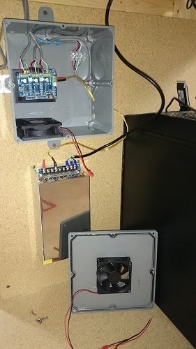

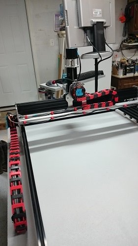

  17. Rich C
    Rich C New
    Aug 4, 2014
    66
    Just an update.
    Here is my wiring so far...
    Air direction-of-travel is in thru the bottom fan (mounted in the box, not the one at the bottom of the picture) across the controller boards and out thru the center of the lid. There should be more than plenty of air-flow across the boards.
    The power cords to the 24v PS, computer, monitor, and router, plug into a heavy duty surge protector mounted to the underside of the table top. I am waiting on my 24v to 12v converter which will mount in the lower right corner of the grey box and will power the two fans. USB cable is not in picture because I won't connect it until I am ready to test.
    Here is the Router side of the wiring with my 3D-printed chain guides and wire looms...
    Everything rolls nice and smooth with no binding.
  18. asb_79
    asb_79 Well-Known
    Feb 19, 2014
    78
    30
    I'd read somewhere, not sure if it was on this forum, that you could run two 12v fans in series off a 24v power supply.
    Maybe someone with some electrical knowledge could confirm this?
  19. Frederic Goddeeris
    Jul 15, 2014
    39
    19

  20. Frederic Goddeeris
    Jul 15, 2014
    39
    19
    This will probably work, provided the fans are identical (brand/type). 24V fans are also very common.
    Frederic
  21. Frederic Goddeeris
    Jul 15, 2014
    39
    19
    It all looks very nice :duh:
  22. GrayUK
    What size is the Grey Box?
