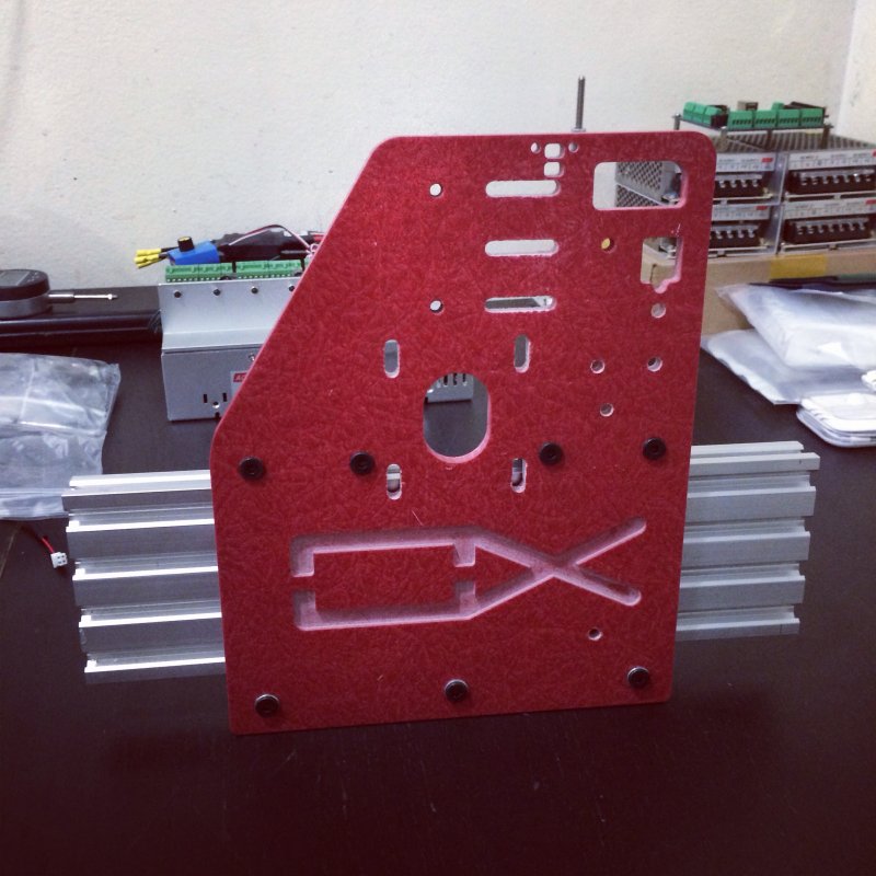

    Just a heads up to let you know that the OX plate models (V-Slot OX_Build_77) hole spacing's have been updated to allow for a tighter pre-load on the eccentrics. The original spacing works but it uses most of the adjustment allowance of the eccentrics and we wanted to be sure that there was more then enough adjustment room to work with, So now there is.
    Special thanks goes to @Robert Hummel for originally catching this and also who's AI plates we used to fix it :)
    You can download the new version under the Files tab at the top of the OX build page.
    If anyone would like to help out by sharing different formats of these new plate layouts that others could use, for instance CamBam, etc.. please send them to me and I will add them to the build files.

  19. Robert Hummel
    Robert Hummel Custom Builder
    Moderator
    Nov 14, 2013
    978
    718
    BAM ! Some fiber in yo face lol :ROFL:
    SG-50 is a non-asbestos ceramic refractory reinforced with continuous fibers to
    increase the toughness, reliability, and overall performance of the ceramic composite. SG-50 can withstand extreme thermal shock, is chemically inert, unaffected by moisture, and non-wetting to non-ferrous metals.

    This is most welcomed in regards to the front X gantry plate where, at least with myOX, I had trouble getting enough of the "pre-load" on the wheels holding the Z length of V-slot. I have the previous spacing and myOX has one eccentric (top one) at "full" and there's just enough pressure to have the wheel touch and be usefull... This is in the 20x60 configuration. I did not try the 20x40 configuration.
    I've discussed a few other tweaks, like a 20x80 configuration and, as others have shown in recent posting, a 4th set of wheels to get a wider grip of the Z V-slot. Not that 4 set of wheels is needed, but the extra spacing between top and bottom wheels could do wonders for those who want to do more than 1" or so deep work.
    Nice to see, and possibly be part of, the evolution and permutations of the OX.

    Hi Mark
    My set of plates that I got from Chris(great plates) is the earlier version and I have the same problem with the Z-Axis eccentrics. In your opinion what would be the easiest solution to accomplish and provide the same amount of adjustment as in the updated plate files?
  23. Chris Laidlaw
    Chris Laidlaw Well-Known
    Mar 1, 2014
    77
    27
    Hi My,
    Builders who had trouble getting the wheels tight enough were successful using eccentrics on all 6 wheels, not just the 3 per the original design.
    Chris
  24. Robert Hummel
    Moderator
    Nov 14, 2013
    978
    718
    To fix this issue simply drill your spacer block mounting holes in the x plate a tad bigger.
    Then tighten the spacer block while pushing inward.
    No need for extra hardware ;)

    You can try two things which should get you working :
    1) I adjusted top and bottom eccentric first, then adjusted the middle one. This got myOX going. I do have to check for squareness (Z at 90 degrees with X).
    2) could add eccentrics to the other side, at least top and bottom wheels. Squareness might be a bit tricker to get.
  26. Robert Hummel
    Moderator
    Nov 14, 2013
    978
    718
    Test fit went well :D
    No movement with eccentrics not tensioned.
    This fiber board is just as stiff as aluminum but a lot lighter :thumbsup:
    Didn't enjoy milling it at all, but it is what it is :zipit:
    This kit will be a surprise in the making ;)
    asb_79, Serge E. and Mark Carew like this.

    Oh, I can imagine you didn't like the milling of the fiber plates! Itchy stuff.
    Actually, I think that when my OX is ready to rock I will have a try on Wood/Epoxy composite plates.
