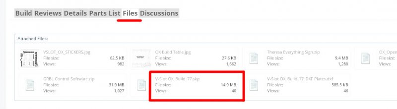

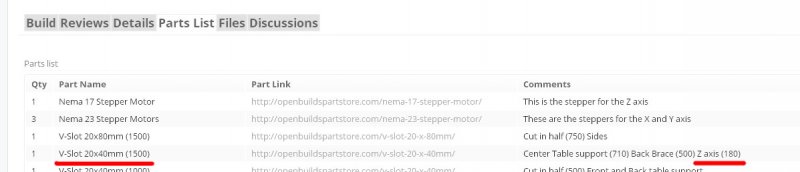

    OK, I'm an idiot. Where do I find the length of 20x60 V-slot for the Z axis. Since my build is bigger, I have to specifically cut this to whatever length it is supposed to be. Where is this model I keep hearing about? The Sketchup I see doesn't have V-slot lengths that I can find. Anybody? Buehler?
  2. Rick 2.0
    2,912
    1,578
    On the parts list. The original is based on using 20x40 but the length is shown in the parts list.
    It's on the Files tab.

    Thanks Rick. I said I was an idiot! I have been in the parts list about a million times and didn't see that.
    I have that skp file, but don't see how to find measurements for the Z piece. New to sketchup.

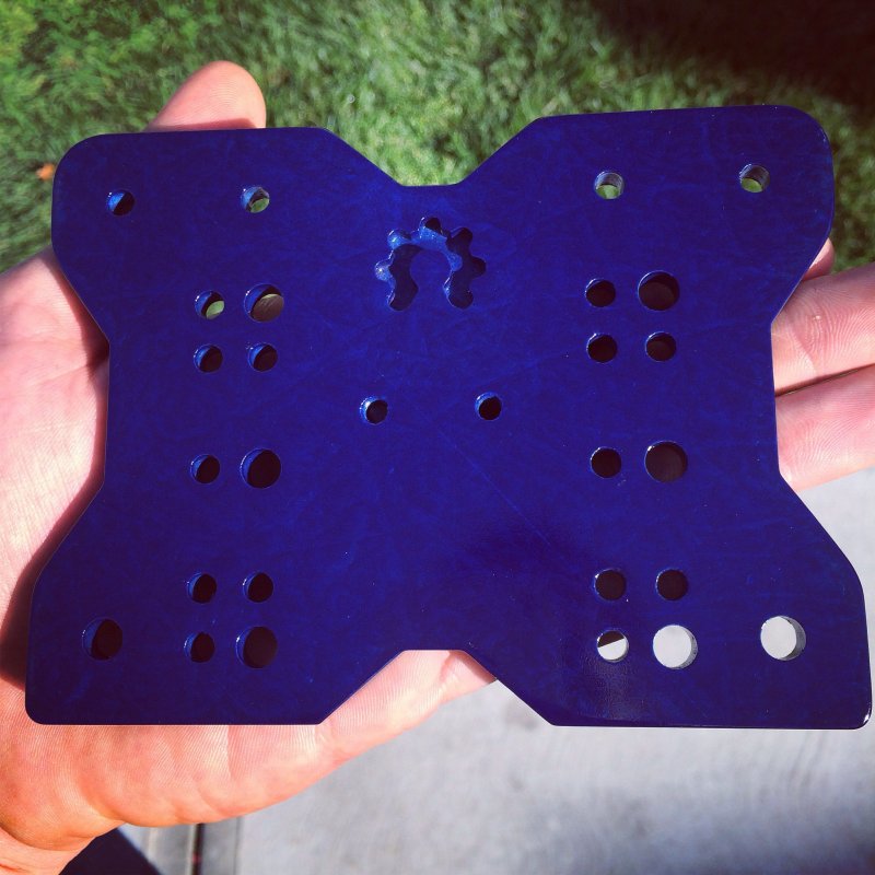

    Well the fiber OX parts are coming out how I was hoping, so that's a good thing :)
    It's a lot of work but the end results should be worth it.
    Here you can see the finish before cleaning and buff, the idea was to get the marble look of the fiber board to show when the light hits it.
    Think I achieved that part
    More to come

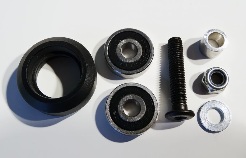

    I need some newbie assistance please! I'm building one of these terrific Ox Routers and I've just begun assembling the components. I have a question about the "Solid Wheel Kits". I looked at the video several times and I didn't see the answer, so I'm asking here...
    The Wheel Kit (see photo) includes a "precision shim". In the video, they show assembling the gantry sides using *completed* wheel assemblies-- so my question is, does the "precision shim" go INSIDE the wheel (like, between the bearing races) or does it go OUTSIDE the wheel, between the bearing race and the spacer-- OR, are there TWO shims, one Inside and one Outside?
    This is unclear to me and I don't want to assemble all this stuff just to have to pull it apart again later ;-)

    The 1 mm goes inside the wheel between the bearings and 1/4 spacer is used outside

    There is a shim between the wheel bearings and if you watch part one of the assembly video, you will also see one or 2 shims between the 1/4" spacer and eccentrics. The video shows the shims external to the wheel and their positions, and there is also one in the wheels between the bearings.

    Yeah, that's what I figured you were gonna say! ;-) Now I've got some wheel assemblies to reassemble...

    John, the wheel kit consists of a 'tyre', two bearings, a spacer, a washer and a screw. The washer goes between the bearings. There is an additional washer (or more)required, depending on where in the structure you are putting your wheel. The videos are pretty awful from a 'best way to assemble' perspective, especially the X/Z-axis assembly - very ham-fisted approach. Look in the 'tips' section of the forum for a much easier assembly.
