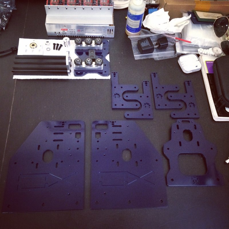

    34
    You're welcome :)
    PS. If anyone is in need of some OX plates I'd be happy to do up a set for someone (I'm U.S. based). I myself used the garolite material for my ox and it has worked out well. I even machined one of the side plates for the OX in aluminum today (on my OX) and it turned out nice (maybe not quite as nice as Robert or Chris's. I think due to the belt backlash, but entirely serviceable).

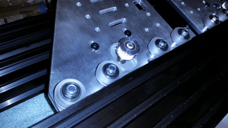

  8. Paruk
    Paruk Journeyman
    Jul 13, 2014
    397
    149
    Talking about the plates of Chris! Just received mine of him and I have to say it's a very, very nice job he did on it. They are looking nice with the black V-slot profiles. Waiting for just a couple of more parts (hopefully end of this week) and have to find a new tap and some screws etc. locally this week. The weekend is going to be building time. I probably will start a build topic to show the results.

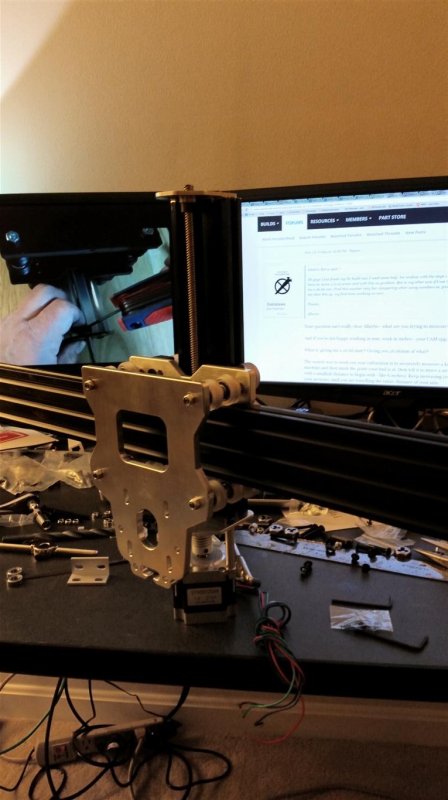

  15. Paruk
    Paruk Journeyman
    Jul 13, 2014
    397
    149
    Did the mechanical build this afternoon and evening. Everything fits good and I have less than 1 mm difference on the Y between total front and total back position. Some fine tuning on the wheels have to be done to get them really perfect. Tomorrow I will make a thread for this build and post some pictures. Still waiting for the stepper drivers to arrive and than the electronic part will happen.
    Thanks to the excellent videos of Mark, all the good info and feed back on the forum and last (but not least) the excellent machined plates of Chris.
