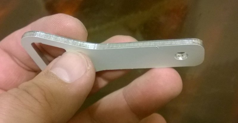

    Hi I was looking long time some vids about how OX can cut aluminium. Well After short pause due too many issues to do I was able to do my own cutting video. I´m quite happy about way cutting works. My material is really very unsuitable for milling, didnt really know should I vacuum it of use cutting fluid, so surface is bit "technical" level. But this step was bigger for me than for mankind.
    v=400mm/min, rpm ~25000, diameter 3.175mm 1-cut, z 0.7mm.
    And I managed to make couple very usable household items, cheers and happy weekend :brb:

    We'll done!
    Vac the chips and lube in little amounts just to keep the bit cool.
    Best bet lube, let 2 passes go then vac/repeat ;)

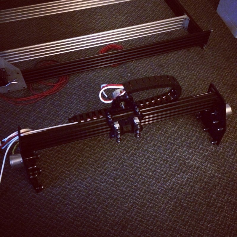

    Am I mistaken, or is that shaft, with the dual wheels at the front there, bending the fibre gantry plate inwards, towards the aluminium? o_O
    Maybe it's just an illusion with camera. :confused:
    Looks really good though. :thumbsup:
    Gray
  18. Robert Hummel
    Robert Hummel Custom Builder
    Moderator
    Nov 14, 2013
    978
    718
    Cam angle and lighting ;)
    The shine of the finish is nice but not perfect

  21. Robert Hummel
    Moderator
    Nov 14, 2013
    978
    718
    What I got done while milling today :D
    All motor wires have been ran / cleaned
    Drag chain installed and it's on to the Y axis I go ;)
    The rest of my parts should be here soon.
    Must say the assembly is very stiff / strong and the weight difference is amazing :thumbsup:
    Frederic Goddeeris likes this.

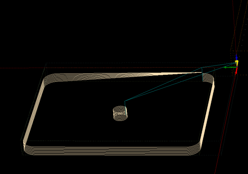

    @ Mark, have this odd thing going on with Sketchucam, see screenshot of the gcode in CNC USB Controller. On the right upper corner you will see that the mill descents slowly at every pass, instead of plunging in and start milling. Had a tricky surprise this morning with milling because of it. Any idea what causes this code?
  29. David the swarfer
    3,604
    1,978
    please send me the sketchup file and your gcode file so I can figure out what is going on.
  30. Paruk
    Paruk Journeyman
    Jul 13, 2014
    397
    149
    @ David, opened a conversation with the files attached.
