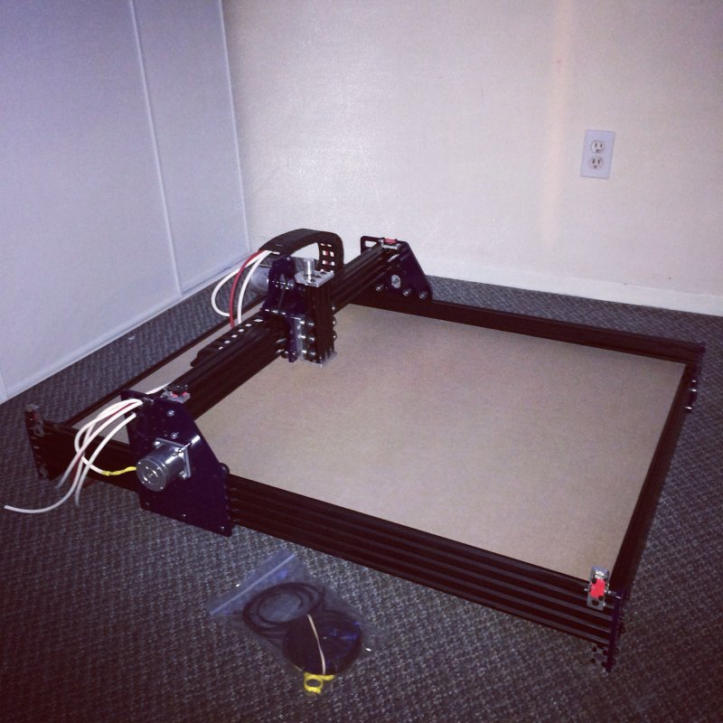

    Just wanted to share what I've used for my OX table.
    I used the machine to drill the series of holes in a sheet of 17mm formply, then I pressed in M5 T nuts from the underside, I'll use offcuts and/or metal clamps to secure my work pieces to the table. I'll use a thin sacrificial layer between the workpiece and the table as I don't fancy replacing it.

    Wow nice job, 160 T nuts !
    Man that must have bin fun :)

    I'm working on mine also, along with the power supply mount :)
    It's 3/4" MDF
    Just test fit after cutting it.
    Sits inside the frame as my supports are 20x60 :D

    The number of t nuts I used seemed like a good idea until I started hammering them into place! Hopefully I won't mess it up to soon.
    Where are you mounting your power supply? I'd be interested in some ideas. Mine is just sitting on a bench beside the table right now.
    In hindsight I should have used 20x60 for the central supports too. I didn't realise the clearance between the z-axis and table would be so little. I probably will do that mod in the coming weeks.

    The power supply will be mounted under the bed in the open space underneath :)
    Also you can't see it "will take a pic tomorrow" but it's 2 x 20x60 and 2 x 20x20 mounted to the side 20x80 to support the ends of the bed

    Did you run your table supports across the bed or length ways per the build vid?
    I used 2 20x80 rails length ways, but with this height there isn't much room between the table and z-axis (maybe 45mm, allows for ~20-25mm depth of cut), I want to change them out for 20x60 soon.
    Also, I noticed that the table wouldn't be well supported on the outer sides with only the central supports, they deflected a bit when I leaned on it. To solve this I fixed two lengths of 20x20 Aluminium angle to the 20x80 side rails at the same height as the centre supports, then screwed the table to these too.

    Like the video I just used 20x20 extrusion where you used the angle

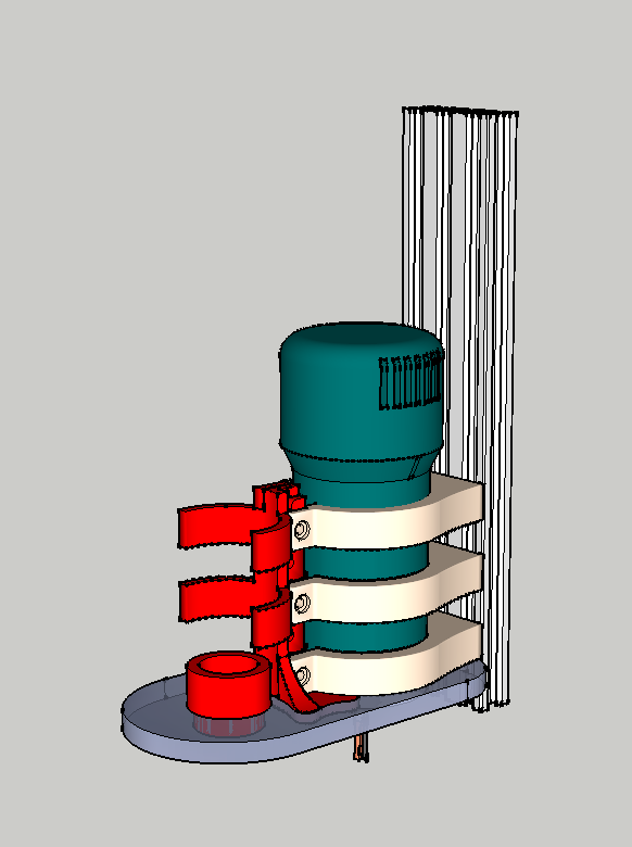

    Little teaser of what I was up to, today. Building a dust shoe for The Buffalo. Screen Shot 2014-10-15 at 20.34.46.png
    Some tweaking yesterday evening and this morning gave me a maximum error on the X of 0.1mm on the Y no error. So did two test cuts for the acrylic plate of the dust shoe. The cutting was done in MDF and turned out exact enough to give it a shot on the acrylic. HELLO Mr. Murphy glad you're here too! The compressor kicked in, I pulled the plug and next thing was that The Buffalo started to follow an unknown path. Emergency button BANG! Did a system reset and tried again. Well that one went right until it came at the second pass of the profile cutout. Slowly but surely The Buffalo started to look around and as a drunk Thai followed the intended tool path. EB Bang again!
    So, today was finished with glueing a part of the spoiler board in the table. Tomorrow another try with the dust shoe. The parts in red are already printed and it all fits snug and perfect. (Were it not for a drunk Buffalo!).:banghead:

    There you have it! An Openbuild with an under build vacuum table facility (device, whatever).
    Screen Shot 2014-10-16 at 18.58.57.png Screen Shot 2014-10-16 at 18.59.51.png Screen Shot 2014-10-16 at 18.59.21.png
    What I forgot to draw is the supports within the vacuum box. This can be simple strips of MDF (18mm) glued in between the rows of holes. This prevents the box from being deformed by the vacuum.
