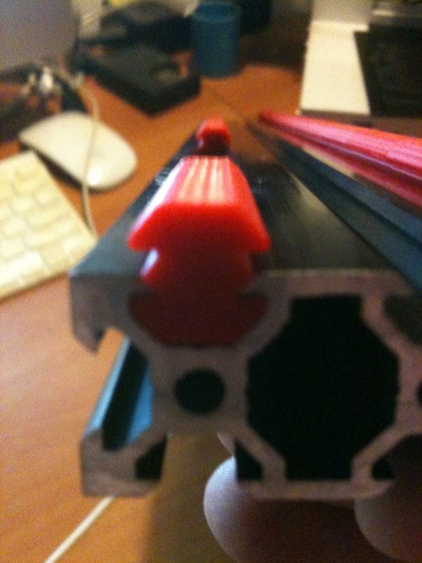

    No, the design is from somebody else and who posted it some time ago in resources. There you can also find a picture of how it is suppose to work.:)

    Let me rephrase that: Is it as stable as bolting the two slots together with screws? :)

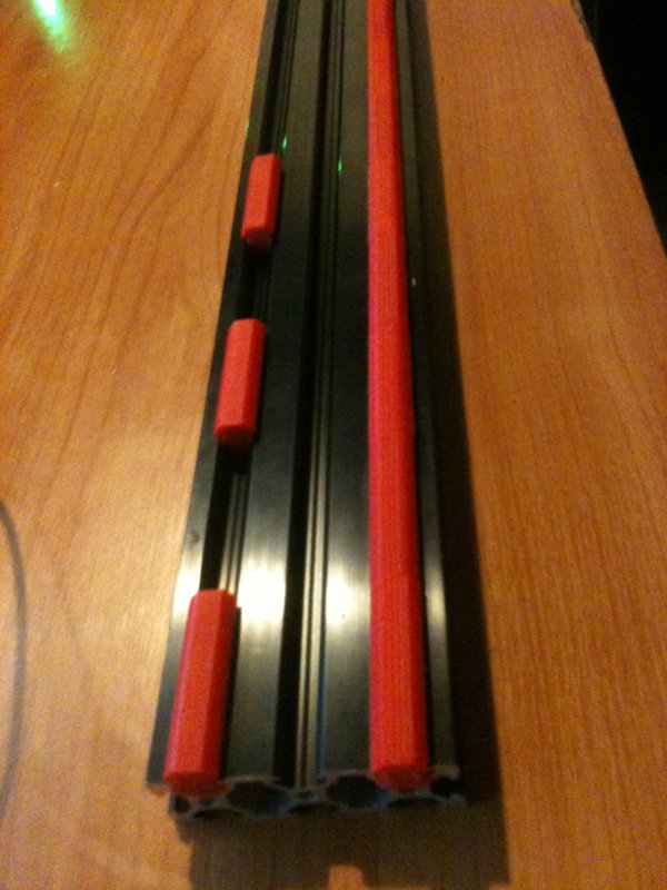

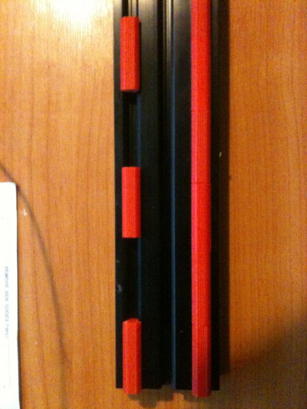

    They go in pretty tight and will line the two profiles up. I guess if you use enough of them it will be surely as strong as the bolts. Aesthetics are also better, no visible holes in the profiles. You can also use them to attach v-slots together in different ways. Make a corner profile for example out of 1 20x60 and 1 20x40. Very strong and rigid.
    I make them from ABS, which is pretty strong. PLA would be less strong, I think.

    Some pics of the v-slot connectors inside the profile, to give an idea about how it works. They can be ordered, price $ 1.15 a piece, shipping not included. The file from resources was not perfect tight and so I had to redesign the model.
