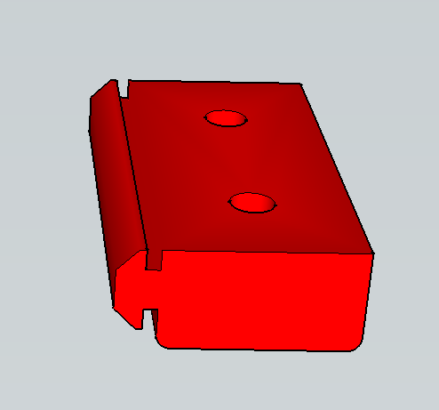

    We'll see the results soon enough from RogueGeek's trials. He also seems to have some experience with the stuff. I suspect he's experienced with the leaking and such issues. Having some gear to test and compare deflection with and without, maybe he can enlighten a few of us as well.
    What would be real interesting is for him to get a hold of a few of those 3D printed connectors to run measurements using them. Especially considering they are 'removeable'. He could test with the exact same lengths of extrusions :
    • just the extrusions
    • extrusions with 3 connectors (either ends and centre)
    • extrusions with 5 connectors (add first and last third to above)
    • extrusions with just the 'joints' made of Aluminite (specifing which mix)
    • extrusions with all cavities filled with the Aluminite (heavier and 'stiffer')
    If using release agent is 'wise', he should be able to slide the aluminite 'connector' right out and start from square one with other alternatives, like :
    • extrusions with 3 bolts
    • extrusions with 5 bolts
    • then adding the Alumilite (which, with the bolts in the way, would become quite permanent UNLESS the bolts could somehow unscrew ...)
    We would then have actual data to use in our discussions.
    If he's willing to do those tests, anyone able to send him at least 5 3D printed connectors ?
    Just a thought ...

    The list is already growing quite fast. I better order extra rolls of the various types of raw material, eh ?

    That's a great idea !
    Could maybe add a hole to screw into a t-nut so any vibration does not cause the holder to travel ... unless there is a tight fit already designed in ...
    Yet an other project for the awaited Micro3D printer.
