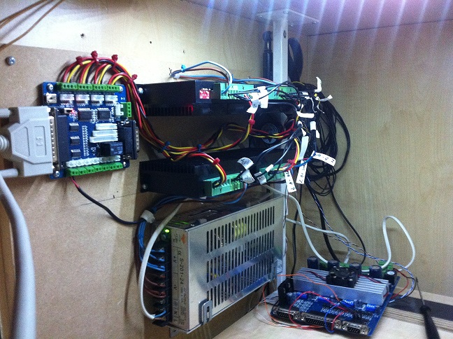

    i have problem with my OX to do circle :-( . i also order new driver and controller card ..i was hoping that it should help but no..same problem...everything else work fine but circle is not good...other with OX with that problem ,,or any idea what can be wrong..

    Is the circle the same every time?
    Cut the circle twice and compare
    If it is consistent the your problem lies in your software.
    If not something mechanical is the issue like belt slip or binding somewhere is my guess

    i think i found the problem...the x was to tight.......now with my new ontrollercard my stepper motor get really hot.....why,, i put the rate to 2,7A ..it is nema 23...should i lower the rate or is it ok if they get really hot ??c IMG_2723p2.jpg

    Pierry, I'm going to guess you are having an issue with belt tension. Make sure your belts are good and tight for the X-Axis and both Y-Axis belts. Slack in the belts can cause misshapen circles as the same number of steps will not equal the same physical movement. Failing a loose belt, I would guess the problem is one of the axis are electronically dropping steps. Check you driver configurations, provided the motors are the same, the configuration should be essentially the same for the X-Axis and one of the Y-Axis drivers (with the second Y-Axis set up to turn the opposite direction).

    Burning hot is not good, warm but able to touch is normal.
    I would say be 100% your drivers are set right, I know not much documentation is provided in most cases.
    If I'm correct the drivers I'm seeing are capable of 3.5 amps so maybe your higher then you think.
    Try dialling it down to 2.5 and see how that works for you.
    The resistors used in the dip switch setting circuit will have a +/- of 5%
