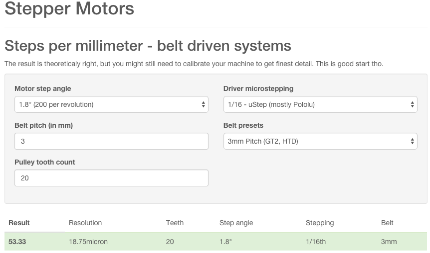

    Meanwhile I see a number of new questions here:
    What do people do with the OX? The main purpose for me is CNC milling of project boxes and lantern housings (see www.hauntedlantern.com and you understand why (and my avatar as well :) )). In the future I want to see if I can turn it into a pick-and-place machine for SMD components. That one is going to be a time consuming and challenging task but I would really like that to work. :) And perhaps some day I will mount a laser to the Z axis. Maybe only a moderately strong one that can cut SMD stencils for me. :)
    Steps per inch: I have settings X/Y 40 steps per mm, Z 400 steps per mm, which applies when you have 200 steps/rev and 1/16 substepping. You can do the math to inches yourself I guess. :)

    I would use the "Steps per millimeter - belt driven systems" section of this calculator: http://prusaprinters.org/calculator/
    I assume you're using the "GT3" belt which I believe is 3mm pitch and 20 tooth pulleys.

    This all does make sense so I am curious where I went wrong. I did assume 4mm per tooth (instead of 3) which is the reason why I ended up with 40steps/mm, but I also did measure it roughly and I am pretty sure that if the deviation was this big, I would have noticed. I guess I will measure again tonight. :)
    Edit: Well I measured it and it was hopelessly wrong. 53.333 it is now and that works. :) I also got the Y axis motors cooperating now. :)

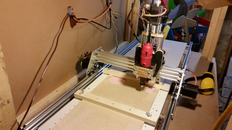

    Here's a picture of my OX. :) There's still some work to do getting rid of the spaghetti, though it is already far better than 10 days ago. :) I have decided that the part where the tools cannot come anyway, is perfect for placing all electronics. :) I do start to understand why some people prefer a single board solution instead of a controller and 4 drivers, though. :) Limit switches still have to be connected.
    I was finally able to do some testing. This is g code that I generated from a (C++) program. It is running way faster than can be milled but that is remedied by just changing a constant in my program. :)

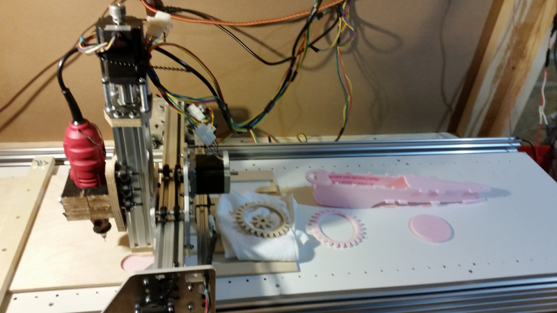

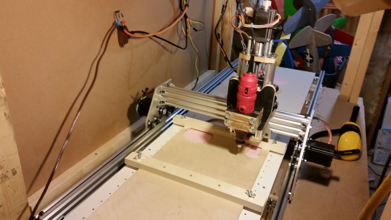

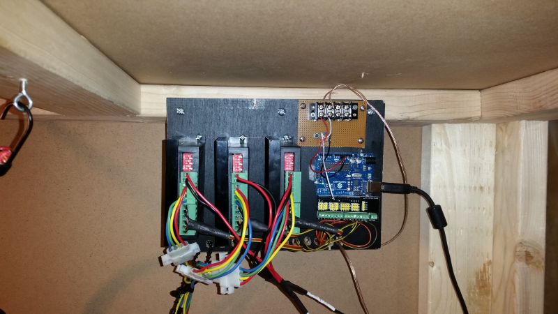

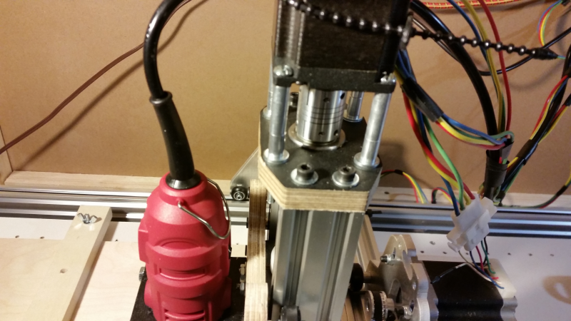

  20. Scooter
    Scooter New
    Dec 25, 2014

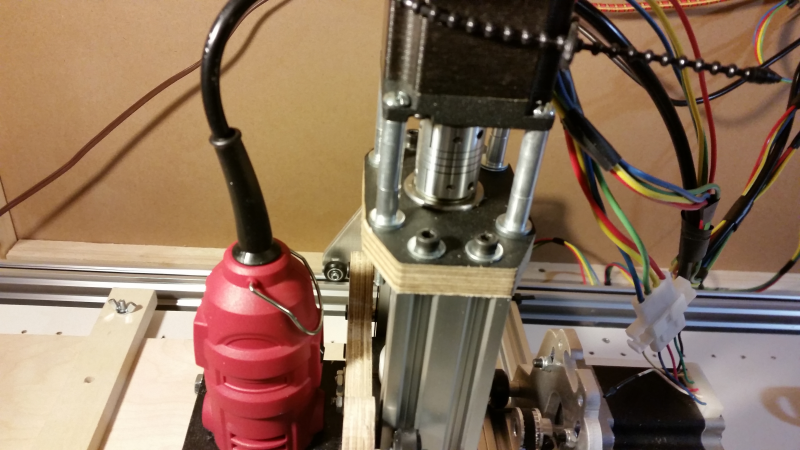

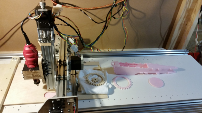

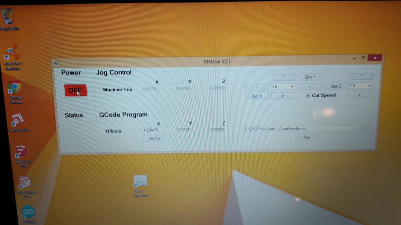

    Hello team. Here is my OX 500 x 1500 build. Started early January. At least 3 orders to the parts store and its mostly done. Modified Z axis with 1/2X10 screw. Using the GT3 belts and pulleys for X and Y. Running X and Y at 1/8 steps of 1.8deg steppers. Z set at full steps because of the finer screw. Was initially worried about the accuracy of the belts but my testing and parts have been turning out good.
    I use Sketchup Make for CAD, Cambam for CAM, I wrote a custom machine control program that covers all of the g-codes that I use. Using arduino uno with custom sketch to drive the TB6600 drivers.
    Few things I learned.
    1. First I was not sure how to cut the v-slot. Finally used an electric miter saw with a regular carbide tip rip blade. This worked good.
    2. For the GT3 pulleys. Replace the 3mm set screws with a larger 3mm machine head screw. That way you have better control when tightening it. I think its easier to get it tight without stripping it. I used a little lock tight. I got the new set screws at a hobby shop.
    3. Make sure the X axis motors are mounted high. Hard to get an allen wrench into the bottom bolts after it is put together
    4. So far I am having good luck with the cheap TB6600 controllers from ebay. But I took them apart to check. Found that on two the main chip was not seated well to the heat sink. Also, the only standoffs are the plastic cover. Bottom of circuit board really close to shorting on heat sink.
    5. If the T-Nuts don't slide into the slot well just file the edges of the screw hole. If you force them they get stuck
    Thoughts on using a dial indicator to check accuracy.
    Not an expert but I figured for my setup that the xy theoretical accuracy was about .005. Now because of the size of step the controlling program has to round to the nearest step. So using a dial indicator is a little tricky. If you tell the machine to go 1 inch its going to be off as much as .005. Take into other factors the accuracy is going to be less that that. Things I wonder about are how accurate is the micro-stepping. If the motor is designed for 1.8 degrees there must be some extra loss of accuracy with micro-stepping.
    Whats next.
    Limit switches
    Better spindle
    Dust collection
    Wire guides
    Replace garage door opener switch with better emergency stop switch.
    For those of you working on the OX now. My advice is to slow down. I'm going through post project depression now, what should I build next?
    upload_2015-2-17_20-7-16.png upload_2015-2-17_20-8-30.png upload_2015-2-17_20-10-22.png upload_2015-2-17_20-11-28.png
