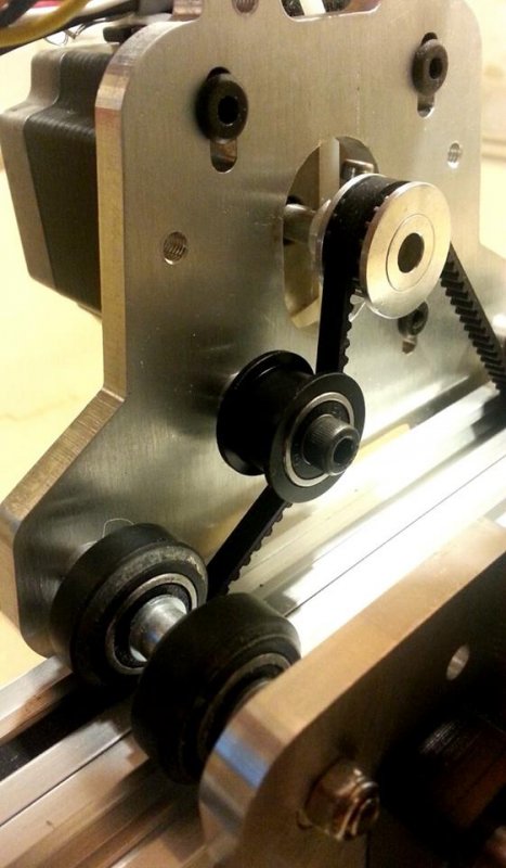

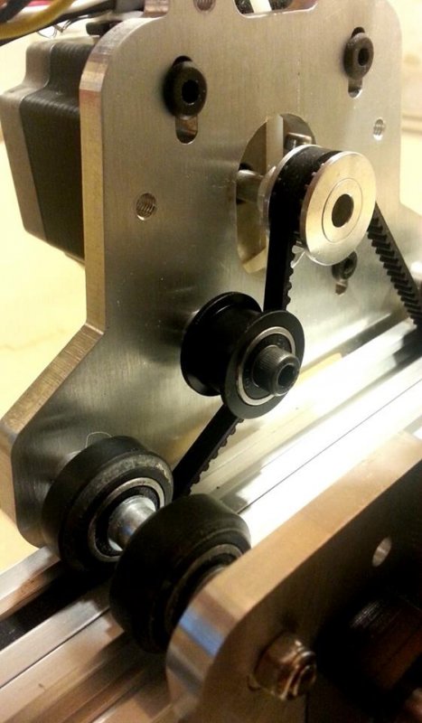

    I have been thinking about adding idler wheels to my X-axis to increase the belt wrap and couldn't figure out a good place to put them.
    It never occurred to me to use longer bolts on the motor mounts!

    Excellent solution @dddman :thumbsup:

    I did it minutes after taking the picture, I was just too excited to show it to you all :)

  20. Scooter
    Scooter New
    Dec 25, 2014
    I wonder if there is a way to use an eccentric spacer on that pulley for fine tuning.
  21. Rick 2.0
    2,912
    1,579
    Nope. Eccentric spacers work by adjusting the centerline of the bolt within a hole. These bolts go into the motor screw holes which have a fixed spacing so there is no potential for adjusting the centerline. In this case, fine tuning is only possible through adjusting the motor up or down.
  22. Scooter
    Scooter New
    Dec 25, 2014
    I was thinking if making a new hole.
  23. dddman
    dddman Journeyman
    Mar 2, 2014
    468
    187
    @Scooter You don't have the space for a bigger hole in the motor. But you can easily make another hole and don't use the screw from the motor
  24. Scooter
    Scooter New
    Dec 25, 2014
    Yes that's what I was thinking. Just drill another hole in the plate. That way you shouldn't have to mess with the motor position anymore. if we could make it work for x axis even better. Thanks for the idea.
  25. Robert Hummel
    Robert Hummel Custom Builder
    Moderator
    Nov 14, 2013
    978
    718
    I think I may just add these holes as an option on my plates ;)
    Great idea guys
