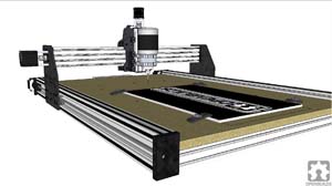

    You also want heavy enough gauge wire for the motors... they draw quite a bit of current and you will get a voltage drop and noise if the power and ground wires are too small.

    Im about to place my order of all parts needed to build the ox. Are the parts on the parts list all i need at this point or have things been changed that isnt specified in the list. Any help would be great.

    I think it will miss some 1/4" spacers and maybe some wheels screws as they are not provided in the wheel kit anymore

    @dddman is correct, you will need 1/4" spacers for the build. I placed my order for some the other day. I found out the hard way. He's also the one I ordered my from

    Okay glad you informed me of this. Also i see the list has 40 precision shims for all wheels but the solid v wheel kits come with two precision shims already. Are these 40 shims necessary for more of an even space

    Which gage of wire are you using? I wound up purchasing 18/4 stranded and sheilded wire. this is what my plasma cutter at work uses. I just assumed it would be OK.

    18/4 stranded and sheilded wire :)

    There is an OX calculator to show how much your configuration will cost under the Files tab and the parts you need are listed in the Parts tab.

    Honestly, that depends on where you live and the electronics you plan to use. I live in Canada and had to order many of my parts from the U.S. That gave me a 30% hit off the top; then I had duty and shipping on items. That added an additional $500 to the cost of my build. If you live in the U.S. you'll automatically save a nice amount. Secondly, I live in a small town where I couldn't source normal components like M5 bolts and my wiring. If you can get your items locally, you save all the shipping that I had to pay.
    Lastly, the choice of your electronics. The quality and size of motors and power supplies you buy will affect the build price. The final price point is the spindle you choose: you could pay $50 for a cheap rotary tool or $500 for a powerful spindle and VFD.
    All my costs brought me in at $1800CDN. That is including the exchange rate, shipping and duty. A U.S. resident could make my exact build for $1100 to $1300. The difference being if you can source things locally and save on shipping.

    I have about $1,200 invested in mine. I made mine a bit larger than the "standard" Ox, which added incrementally to the cost. I did use an earlier version of the spreadsheet, but mostly manually selected things from the parts store because I started the build before I found the spreadsheet. I used it to keep track of the things that I ordered.
    One option is to buy the complete kit from Spark Concepts, that make the xPro CNC controller. That goes for $1,000, and looks to include most everything.

    The CNC xPro is an all in one solution. You don't need anything to drive the board. A USB cable goers from you computer to it. It interprets the g-code and drives the stepper motors for you. It is "strong enough" for your acrylic and wood jobs you listed. This is because it is a combination of the machine parts that dictate the work you can do. Your driver and motors determine how fast you can move around the work area and the force they can apply on the spindle. Your spindle decides how fast you can cut through material and how deep each cut can be. Lastly, the ridgidity of the machine dictates how much push can be placed on your endmill without the machine flexing.
    The standard OX build would do your listed jobs. A Dremel would merely require you to do things slower than a stronger router or spindle option. Secondly, it will not offer the same accuracy as a quality tool. Even the Shapeoko 2 with a Dremel knock off unit could do some aluminum work.
    As for the motors; I bought all Nema 23's. It only requires a different motor mount for the Z-axis. The ones I bought are rated for 2.8A and the CNC xPro is rated 2.5A. That difference is only minor.
    From what I've read, there is a couple v-slot retailers in Europe that you can buy from. Some are more preferred than others. But other members can say for sure.

    I'm using 223 oz. NEMA 23, and it is plenty of torque. I would feel comfortable using a full size router with this. Currently have a Makita RT701C, which I love. Goes all the way down to 10,000 RPM.
