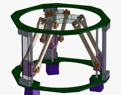

    Thanks Mark - most of the 3D printer platforms try to keep the build stage horizontal relative to the extruder - actually it's really fascinating to watch such Delta platforms run:
    http://kiestu6.com/videopage/on/0IkqWBiyBts.html
    But I am looking to build a platform with six degrees of freedom. And here is a University Project that went nowhere - flightsimulator game console. No Sir. I am too old for Video games and want to find use for such work that are beneficial to people - children who are physically less fortunate than I am. This design comes pretty close to what I need....
    Everman uses linear screws - after seeing your work I am leaning towards a rack and belt six axis motion with perhaps six arduino based motor controller but all synchronized through a joy stick and/or preprogrammed (by a qualified physiotherapist and a physician and a Physiscist :rolleyes:) SD card.

    That is a fantastic project Gopal, I am looking forward to seeing your build. This video is very cool and makes me want to build one of these now using steppers :D I'm going to wait and see how your build comes along and perhaps my table will be clear at that time, so that I can build yours.
