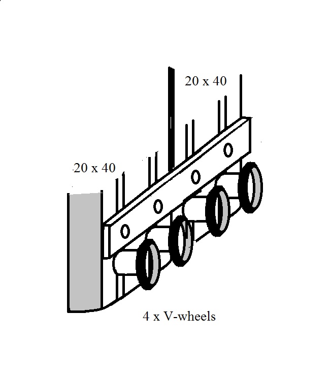

  5. Gopal
    Gopal Well-Known
    Jan 12, 2014
    41
    25
    This may sound like a very amateurish approach born out of impatience.
    Amazon sells precut 80/20 extrusions. I ordered 4 pieces of 20x40 – 305mm long (20 series). My plan is to use cross coupling straight plates to join two 20x40 extrusions for each side. Mount the V-groove wheels using the T-slots with the straight plates as the aligning guide. So, the gantry support plates will have an overall 80mm width and 20mm thick. The straight plates will also allow me to use the eccentric spacer to tighten the wheels to the V-groove.
    (don't know how to insert a sketch here)
    I could have used the 20x80 (40 series) but that would allow me to mount only two wheels. But I will use that to reinforce the X axis plate with 20x80 V-slot plate.
    So goes my thinking ---
  6. Gopal
    Gopal Well-Known
    Jan 12, 2014
    41
    25
    Here is my sketch!!!

  7. wrdutcher
    wrdutcher New
    Dec 4, 2013
    19
    If I understand you correctly, the T-slot is used as temporary plates somewhat like the Routy vertical extrusions minus the plates mounting the wheels directly to the T-slot. Then use it to cut the actual plates and then install them. I like it, a self enhancing router. You just need to make sure the wheels are tight enough so that they do not move in the slot, or you could mount the wheels using corner connectors as in some of the example videos. You could do the same thing with V-slot, using a washer over the V grove and it never hurts to have a few extra pieces of V-slot around anyway. You always find a use for them especially if you hang out in the Build's area of OpenBuilds for a while.
    Edit: Putting the straps on the outside ends up against the spacer connected to the wheels will keep them tightly against the slot they are riding in.

  8. Gopal
    Gopal Well-Known
    Jan 12, 2014
    41
    25
    I am not sure I follow your statement here or the implied consternation.
    I am using two blank T-slotted extrusion plates joined together similar to the Routy vertical extrusions just like @wrdutcher has understood. I had no idea that buying standard Al extrusions from 80/20 Inc directly or thru Amazon would be interpreted as "going to a competitor's site". Neither of them design or build OX like units!!!
    I am exploring the possibility of using a different approach to supporting the X-Z axes and the spindle motor. I did that because I have no machine tools to cut and shape that part to size; besides these are temporary support structures for the gantry. It has NOTHING to do with V-slot extrusions or the wheel or the belt&pinion design. So I wonder what prompted this remark "V-Groove from here on the extrusion from there - Cool" from you. Aluminum extrusion is a process and many organizations do that, the well known is the 80/20 Inc. V-groove is a design approach used by OpenBuilds to come up with a linear slide. Others use guide rail shaft with slide bearings, V-groove rails bolted on to Aluminum T-slotted extrusion, steel V-groove bearings etc.

  9. Gopal
    Gopal Well-Known
    Jan 12, 2014
    41
    25
    As I said, it is a loud thinking process. The straps will be certainly thinner than the spacers that support the wheels. They will be used only to align the wheels and provide a fence to push against for the eccentric spacers. I am considering this approach as I might need more Z-travel and also the design can easily be borrowed from Routy.
    I already have ordered several 20x60 and 20x80 V-slot pieces from the Parts store but I think they are the Lite versions - meaning thinner walls. I wanted to make sure that the end plates have thicker wall extrusions. Besides, I can get them in 305mm, 610mm sizes from 80/20. Parts store has them only in 1000mm or 1500mm lengths and I don't even have a good hacksaw to cut them to size!!!! I also have the several gantry plates, L and corner brackets, 3mm belts and pulleys, six Nema23 steppers and 3 Nema17 steppers - so I am all kitted up waiting for Mark to make his final approval on the OX.
    Once Mark is happy with his design, I can perhaps ask him a favor to increase the height of the plate (assuming that is mechanically appropriate) so I have about 4"-6" of Z-space. This will be my FIRST cutting machine which will be dedicated to making parts for my other pet project.
