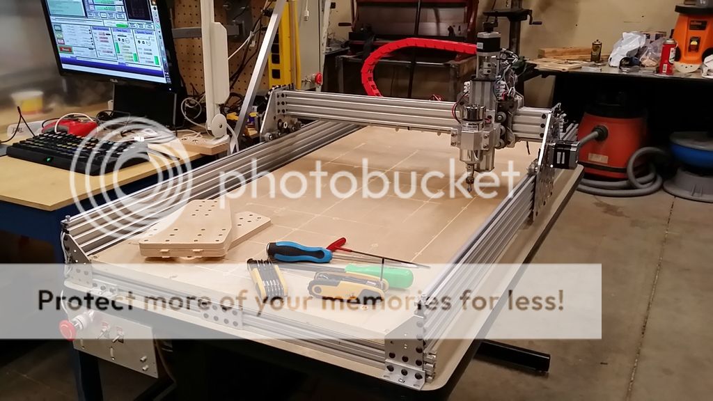

    Here's my Ox;
    I can barely force the gantry out of a stopped position. When moving it is possible to make it skip.
    I would avoid nema 17 steppers. they will work for a Ox, but they really can be pushed around very easily. Nema 34 steppers are over kill IMO until you start talking about that 4x8 table with big lead screws, 25mm (or bigger) linear rails and steel where a Ox is Aluminum. On the Ox shown above I'm using a mix of steppers. 23's on the x and y axis and a 17 on the z axis. that 17 is ok because it's driving a 8mm single thread screw and the power curve of the stepper is just right for this exact application - like the nema 23 425ozin steppers on my bigger machine are just right for that application. Steppers hooked to screws always have a huge mechanical advantage over belts.
    I hope I answered some of your questions, if not I'll try to be more specific.
