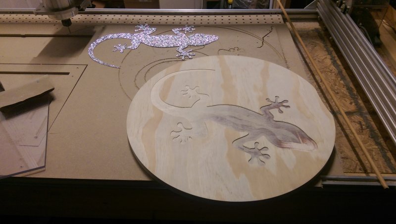

    In my first attempts to use SketchUcam I was getting quite frustrated ... even more than with SketchUp itself ...
    What I have learned about SketchUcam while working on my first sign (see post under myOX link) is that one should breakdown a seemingly complex task into smaller tasks, just as seen in the "seatknob" video. I should of thought of this, being an aging programmer ! :oops: Remember the "top down approach" ?
    SketchUcam, when taking this divide and conquer approach, can be very good and easy to use. However, it will require you do some prep work, as seen in the "seatknob" video. This actually helps in documenting the job ...
    In addition, by breaking down a job one can also do tool changes. The roughing in the video could be done with larger end mill. In this particular example, the time needed to change the tool is probably more than what could be saved by roughing with the bigger end mill.
    All this to say I am starting to love SketchUcam as it allows me to have more control. Of course, it won't allow me to do everything I can imagine needing, but it certainly will do a lot.
    David (the swarfer) was of great help when I ran into 'issues' with SketchUcam, all where really me not having thought my project through, much less worked with the tool. By breaking the job into three parts, it went from over 10 hours with me scratching my head for days trying to figure out why SketchUcam was not behaving, to only 20 mins on the same CNC machine. The needed prep work took only minutes : take a copy of model, add reference point to keep things aligned within the work area and pick elements to be done at each step to then do merging of the resulting gcode files to run as a single job.

    In your enhancements, have you thought of doing/allowing pockets with some form of spiral patterns ? Pocket circles, for example, from the edge in or centre out ? Maybe figure a way around SU offset issues by pocketing a shape inward while always staying within bound of previous trace ? If done as a continuous trace, it would stop once bounds does not allow any more material removal. Complex shapes would still require 'zoning'.
    Of course, all much easier said then done ...

    I have looked at a number of methods of pocketing complex shapes and all require a lot more math than I have (-:
    Voronoi diagrams are probably the best but very complex mathematically. maybe I'll find a nice code example as a reference one day.
    pocket circles -> just use the 'plunge hole' tool, set size and depth. at the moment it will be cut using the depth first algorithm but the new 1.3b (soon soon :) will have 'diam first' as an option, ie, spiral out after helical boring the center to depth.

  21. David the swarfer
    3,601
    1,974
    no
    no, because it does not generate any line segments, it is a 'plunge hole' extension so no actual cut lines are drawn, just a symbol for 'here is a hole' with variations for plain hole, big hole, < 100% deep hole, countersink and counterbore.
    the actual cut arcs are generated by the gcode generator according to the current options that are set, namely
    ramping on/off
    multipass on/off
    Z-zero on/off
    depthfirst on/off
    stepover% less than or greater than 50%
    all those affect how the plunged holes get cut! (-: (64 combinations so far...)
    if you want to try generating spiral pockets by hand you should load the TIG smartoffset tool
    http://sketchucation.com/pluginstore?pln=TIG_Smart_offset
    and then compare it to the Sketchup offsetter (which sucks). just draw a random shape with a face, then offset inside that multiple times until the shape is too small. try 25, 50 and 75% of your bit diameter. set the lines to 'centerline cut' and run the gcode through a simulator like OpenSCAM (has a new name) to see the results.
    watch out for sharp corners!
    and what do you do when the internal shapes turn into 2 shapes?
    that exercise will give you a real appreciation for how hard it is to do some of this geometry (-:
    and keep in mind you can SEE the shape, whereas the code only has the points around the edge from which to calculate everything.
    right now I am very happy with the existing pocket tool, I can split a shape and achieve a pocket with it faster than I can write about it or explain how to do it. I should do a video on this (-:
