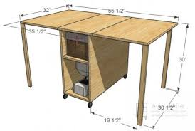

    I was thinking of something along this (disregard the dimensions shown, I just grabbed something close off Internet) :
    The center portion would be a fixed X-axis (and the Z) while the flaps would act as in and out feed tables (might need double folds to work longer work pieces). Just need to figure out the working of Y axis. There is the concept used by a PhlatPrinter, meant for foam sheets. It might work for wood, using a waste band on raw material to grab (one can see such a technic from marks on some 2x pieces ... little indent marks). Those 'grab' rollers would be fixed in the centre portion as well, outer edges near folds. Just not certain it would be precise enough or allow for the needed speed to move the work piece back and forth. Would need adjustable guides, between front and rear rollers, to keep the work piece nice and straight throughout the run ...
    It basically becomes an OX on a stick, kinda. Set it on a surface it can grab hold of and let it move the work piece sandwiched between it and the work surface. It could be about 12" deep (Y) by however wide X needs to be plus the overhead (plates, ...). Height can be what ever Z needs to be (12-18" at rest / low position ?)
    Heck, would not even need the shown table, IF the back side of the work piece could slide easily on the host work surface ...
    That would be as compact as an OX can become, eh ? Short of somehow making the X-axis telescopic ! :rolleyes: hmmm ... there is probably a way of doing that as well. Maybe an hinged mechanism to fold in two during storage or transport ? As long as the top and bottom line up with a clear path and no 'bump', it should be good to go, right ? The two halves with an angle cut (not 90°) to avoid having the joint on the same set of wheels ... would need to be rack and pinion driven though.
