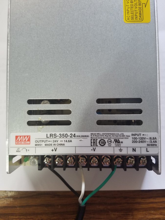

    I just completed the build of my Workbee 1010, awesome looking machine and very excited. But now I'm in a quandry; I don't know how to connect all the motors, CNC xPro Controller, 24v Meanwell Power Supply, and computer. Can I get some help?

    Thanks for the info, guys. I found a lot of information on hooking up the CNC controller but the information on the Power Supply wasn't very helpful. I am not an electrician and all of the information seems to be geared toward someone who understands electrical schematics! Unfortunately, I tried copying what I saw on Youtube, as far as which wires go where (on the Power Supply), and ended up FRYING THE UNIT. Just wasted all that money! What I'm looking for are instructions that tell me which wires in the power cord are Hot, Negative, and Ground and then which terminals they are attached to on the Power Supply. Since I have to order another PSU, I hope there is some "simple" wiring info on this. Any help in this direction would be greatly appreciated (my wallet will appreciate it, too!).

    Typically in US, if you cut the end off a computer 'IEC' power cord
    Black is 'LINE'
    White is 'NEUTRAL'
    Green in 'GROUND'
    In the US, looking at the outlet, the shorter slot is Line, the longer slot is Neutral, the round hole is Ground.
    Switching power supplies will have an input section labeled L, N, G for Line, Neutral, Ground. Their output while be + and -, + for DC positive and - for DC negative. The term 'Hot' has no meaning.
    You may run across a different color scheme with your AC computer power cord. In this case,
    Brown is 'LINE'
    Blue is 'NEUTRAL'
    Green-Yellow is 'GROUND' or sometimes called protective earth.
    Hope this helps. Send photos next time before you apply power and someone will probably reply. Smoke bad, let's not do it again.
    Rick 2.0 likes this.
  19. Keith Kimura
    Jun 26, 2018
    38
    Thank you Craig. Just ordered a new PSU. I'll definitely get verification before applying power next time. Yes, smoke bad! Popping noises, too! Just want to say again, Thanks. This "community" environment is reassuring to know there are others out there to give support and advice. Your time is well appreciated.

  21. Keith Kimura
    Jun 26, 2018
    38
  22. Keith Kimura

  23. Rick 2.0
    2,912
    1,579
    Yeah, that'd do it. On a positive note, you had the green one in the right spot. :thumbsup:
    Next time, white to N and black to L. Wires from +V and -V go out to the controller/drivers.
    As for the wire colors, the diagram may intentionally be left vague as different manufacturers use different ordering to their wires. If you have a wiring diagram that came with the steppers it'll tell you which wires are matched pairs to fit into the A1, A2, B1 & B2 positions. If you don't have the wiring diagram you'll need to find the matched pairs. Take 2 of the wires and hold the bare ends together. If the stepper is noticeably more difficult to turn than it was without the wires touching, you have found a matched pair. Connect them to the A1 and A2 positions and connect the remaining wires in the B1 and B2 positions.
