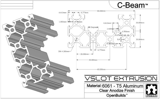

    Could someone post me a picture of the belt within the Y axis cbeam please? I'm trying to figure out clearance for an idea and id like to know how big the gap is between the pinion and the veritcal internal wall of the c-beam is.

    @sharmstr Thanks thats cool, appreciate it. i think there is a gap
    I have an OX, modified, at the moment and have noticed how much flex there is in the y axis 20*80, which I have fixed. However, I'm looking at upgrading to a larger format with c-beam,using very long sections so i can do a full 2400mm work area. This with workbee plates (I like the double wheel idea) and c-beam for X looks like it will be worthwhile.
    On my current Y-axis I have a 40mm*10mm flat bar bolted on the inside the whole length on the Y and it works great. I wondered if I could do the same, with thinner stock, inside the c-beam and with the workbee plates without interfering with the pinion gear.
    So if you were looking at the cross-section of the Y axis, down the internal channel how much of a gap is there?
    If i were to guess i'd say approx 5mm - the belt in the channel is the middle 6.773 but the gear would go slightly beyond that im just not sure what it is. if it leaves too little room then flat bar wouldn't add anything
    Hope that makes sense.
    Alternatively - is c-beam at 2600mm (ish) stiff enough on its own?- the workbee plates don't allow any intermediate supports.

    I used some feeler gauges and got an approximate gap measurement of 5mm. You wouldnt be able to use a 40mm tall bar due to the nuts holding the belt wheels. Though I suppose you could change those out for low profile nuts.... maybe. A 25mm tall x 4mm thick bar running the length could be used. Hope this helps.

    That is exactly what I was looking for, thank you very much. I appreciate the effort.
    The Red bar feels somewhat insignificant when shown like that so this is probably not a good idea, although the low profile bolts allowing a 40*5 bar would help. I think however that this would be far less rigid than the 40*10 that gave me the idea. So I'm not sure it stacks up.
