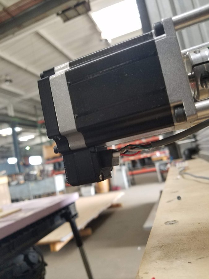

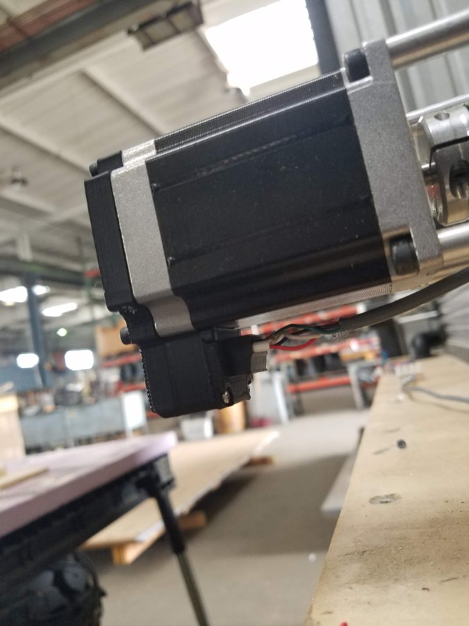

Openbuilds Xtension Connector Lid for Nema 23 Cover 2019-02-12
Xtension connector lid for motor cover.
