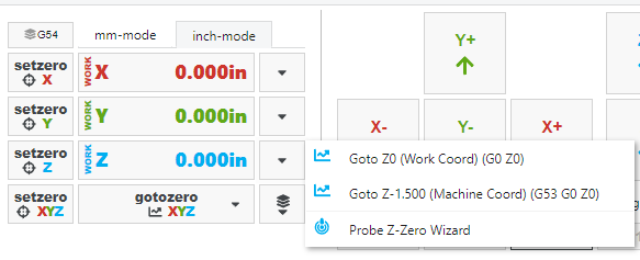

    Thanks, XYZ without the automatic tab selected works fine, I think. I looked at the log and G4 P0.4 is in the log. But when I hit the - Goto Z0 (Work Coord) (G0 Z0) the bit jogs down but stops short of the surface of the project stock.
    I know we are in different time zones and I will be away most of the day tomorrow, but I'll try to post more pictures of the log screen in different scenarios. Capture.PNG

    Update, there was a calibration issue on the Z Axis Old $102 value was 50,059 had to change to 208.58. After changing and running Z Axis probe the work zero command brought the bit to the top of the work piece. Automatic XYZ probe still does not work.
