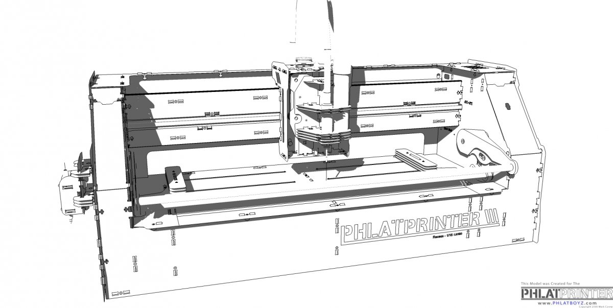

  9. Mark Carew
    2,785
    2,504
    @Balu lol Was it that long ago!? :) I do apologize as the plan was to release the MK3 as a build with all the trimmings but we did get busy and for that I am sorry.
    I will post the files here and if later we have the time we will release the MK3 as a full build.
    In the meantime, I have been working on a V-Slot Phlatprinter and have 2 prototypes on the table but the drive roller system is the bugger and I am not happy with it yet.
    So here are the unofficial release of the Phlatprinter MK3 plans!
    Zip file attached
    You can break this down to smaller sheets for cutting (we have it setup for 4'x8' sheets). You can use 1/4" material.
    Again, we hope to put up an official build with parts list and the discussion thread so that we have a place to show off mods and builds for the Phlatprinter MK3
    Hope this helps have fun guys and be sure to share if you build one we would love to see it!

  19. David the swarfer
    3,604
    1,979
    first make sure you are using the latest version (-: (of both Sketchup and SketchUcam)
    then, private message me your problem file so I can look at it.
    one thing that can affect this sort of thing is what OTHER plugins you have in addition to SketchUcam, and of course available memory etc. try purging that big drawing of all deleted stuff so Sketchup has less work to do.
    in terms of generating Gcode, you can speed that up by selecting only the stuff you want code for, SketchUcam will only process the selections. This means that on a large drawing where you are only generating for a portion of it that is within a reduced safe area, if you select the stuff inside the safe area it will be much faster.
    the other thing to watch for is having too many line segments in the first place. particularly drawings that originated in other CAD packages, or from a scan/vectorize process, can have many tiny line segments that you do not need.
    If you add cutlines for all those tiny lines it takes ages, as does generating Gcode from it. I use a plugin called, IIRC 'edgetools2' that has a 'simplify' tool that will combine small segments into one longer segment.

  22. David the swarfer
    3,604
    1,979
    Just a general note to anyone wanting to cut these components from the original drawings.....
    in the the PP3 drawings and presumably the others, there are slots that are less than 1/8" wide (the ones for the edge retainer nuts on the backplate, for example).
    Therefore you cannot generate working cutlines using a 1/8" bit.
    Use a 3mm bit instead, which will fit into the slots.
