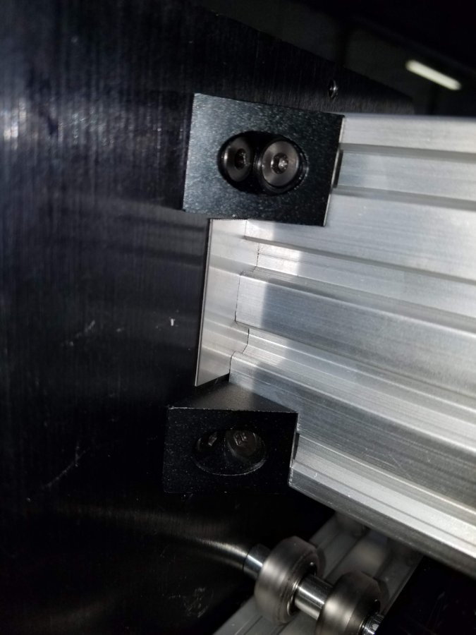

    Here are some pictures of my X gantry. I used a square against the side plates and measured on both sides of the C-Beam.

    And these are pictures of the Y axis while checking for squareness

    Well guys, it does seem like the C-Beams were not cut perfectly squared. I haven’t checked the v-slots, but if they used the same machine to trim them all, I am guessing they were cut crooked as well.
    Do you guys think the openbuilds store should send me replacements or should I attempt having someone locally square the edges? I have a 12” sliding miter saw I use for woodwork. I would need a new $100+ carbide tip blade and square my saw again. It seems like a lot of work and money to fix a problem I shouldn’t have had in the first place.
    I am going to test the other two C-Beams and see if I get lucky with one that has the edges squared. Will post back.

    OK. Last post for now. I checked all the C-Beams and none of the edges are squared. What a bummer; I was hoping to have this machine up and running by the end of this week, but it looks like it won’t happen.
    The picture shows how much clearance there is when it lays flat on its edge.

    Hi Guys, I thought I would give you an update and resolution. Hopefully this information will also help the guys at the openbuildstore.
    If you recall, while I was putting my Workbee 1010 together, I had a tough time getting the X-Gantry squared with the Y axis. After hours of testing and rechecking, I came to the conclusion that the C-Beams were not squared. In fact, some of the pictures above show how off they were which was very surprising to me, yet I thought some times things like these happen. I contacted the openbuilds store and they were great; excellent customer service. They shipped replacements right away, in time to finish my build over the weekend.
    Well, the replacement C-beams came in and they were not squared either. I decided to take a break for a day to gather my thoughts. After careful inspection on every single extrusion, I came to the following conclusion. When the holes were tapped, it appears that the aluminum around the holes at the very end of the extrusion bulged outwards making the ends wobble. I am guessing it is due to material displacement. Therefore, the ends of the extrusions were not perfectly flat anymore due to the bulge and exhibited a slight rocking motion when placed on top of a flat surface. I tried filing it off, but it didn't work well as it was nearly impossible keeping the file flat. I went to Home Depot, bought a 96 tooth Diablo non-ferrous blade for my miter saw. After about half an hour getting the miter saw perfectly calibrated and true, I took a couple of millimeters off the X Gantry C-Beam and 20x40 v-slot. The 20x40 fits inside the C-beam, so I used tape on the top side only to hold the v-slot firm on the c-beam. This cut solved my issues with the X-Gantry alignment with the Y-axis. In addition, since I ended shortening my X-Gantry by 2.53mm, I had to trim the same amount (2.53mm) off the other 2 v-slots of the frame, so everything would line up properly.
    In conclusion, be careful when tapping threads on your extrusions. If they need to be flush against another surface, make sure you tap those holes with a sharp tap set and lubrication. For the guys at the openbuildstore, after tapping the holes, you need to make sure the extrusions are square and have no rocking motion when place on either one of its ends. You could cut them a bit long, tap the holes, and then cut them to final size. My build ended being 2.53mm narrower, but it is perfectly squared now.
