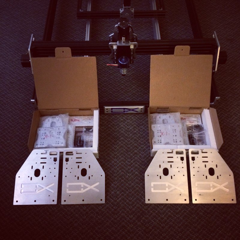

    I reckon you will be making some cool stuff in the near future. It's definitely the way to go. :thumbsup:

    Well as promised!
    Kit update :)
    Kit 1 is complete and ready for grabs.
    The kits will all be the same
    Four main plates with belt clips
    Custom end plates with belt clips
    Aluminum motor spacers for X & Y
    1/4" universal Z plates Top/Bottom "nema 17/23"
    Name plate/brace
    608zz bearings
    4 x 70mm M5 bolts for X axis
    M3 hardware for belt clips
    FCFS By PM Ty

    Did you saw my question about accuracy and the work plate?
  26. Robert Hummel
    Robert Hummel Custom Builder
    Moderator
    Nov 14, 2013
    978
    717
    Accuracy has bin noted @ .002 with proper calibration and electronics.
    My laser Fiber OX is dead on but the axis are not loaded like a router would be.
    As for the plates I clamp the sheet, mill leaving -1/128 to hold the part then zero the mill and then run the final operation that cleans the plates edge

    I was expecting something along the lines of 0.02mm/0.05mm of accuracy, so that was really great news :)
    That solves my indecision :p
    Thanks Robert, much appreciated :)
