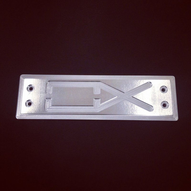

    Very nice. I like it more in alu.
    What will be overall size and cutting area.

    I'm going for 900mm x 1200mm
    Was going to go 1500mm but it would take up to much room in my already cramped basement shop :)

    Nice plates :) What thickness is it on the aluminum you use and what kind of aluminum alloy is it?

    Ty!
    It's turning out better then I expected
    It is 1/4" econo plate 6061 :)

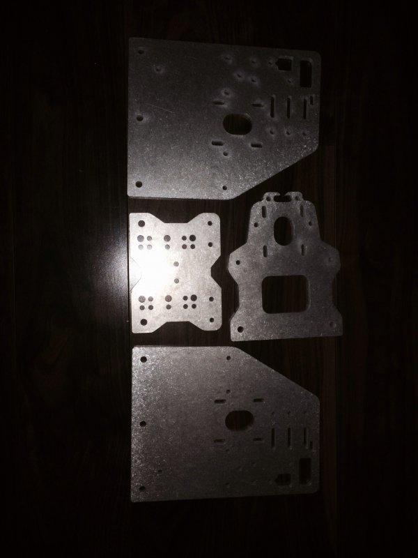

    :):D:thumbsup:I finally got my 1/4" 6061 aluminum parts made.. I took the files to a friend with a water jet table, modified the files to eliminate the "OX" logo because the machine only does "thru" cuts. Then threw the cut parts into a tumbler to smooth out the edges...
  12. Derwin Palacpac
    Jan 22, 2014
    14
    This is the finished parts. Still a ways to go before the OX comes alive! image.jpg

    Wow not bad for water vs metal lol
    Tumbler? That thing must be big, have you test fit eccentrics ?
    I was goin to bead blast mine but was worried it would oversize the holes

    No i havent tested the eccentrics. I will be ordering most of my parts this friday. Is there something other than just a hole there? Yea, the last part of the video shows the parts in a tumbler of stones.. The stones can be changed out depending on how coarse or smooth of a finish you want.lol looks like a big shaky tub...

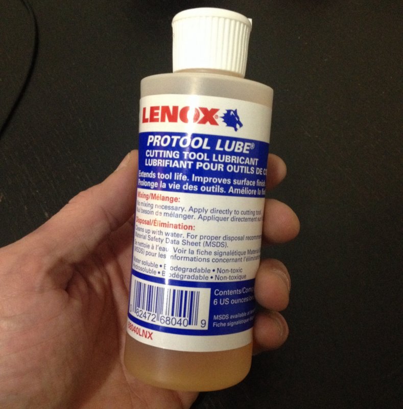

    I popped by my friends metal shop and picked up some more off cuts and he gave me a sample bottle of this :)
    He said to give it a try and that he was sure id like it, will see :)

    It's probably vegetable oil <snicker>

    Lol it would not supersize me, haha
    Hmmm and it's local, I bet the place I get my end mills carry it.
    I will check it out ;)
