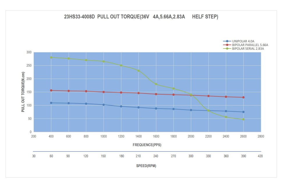

    I have my machine finally running on the N23 on 50v ps and only able to max out the no load feed rate to about 2500mm/min before one of the y axis stepper stalls out.
    What motor/driver and power supplies are u using on ur 25mm ballscrews?

    If you know the exact motors you have that is important info, high inductance motors (higher than "normal" rated torque) will have poor high speed performance..

    I found the specs of my motor from the Ebay store I got it from and its 6.8mH vs 4.0mH from the one here on OB. I guess that really the cause of it stalling out too early and not getting near 300ipm or 150ipm in my case (2505 screws) per Julius.

    There are plenty of low inductance motors to try, yes the openbuilds ones are good.. some of the 8 wire steppers where you can run the coils in parallel get you very low inductance like 1.8mH range.
    What's the rated torque and amps of the steppers you have?

    Lower is better for speed but you are limited with driver current, so as the Henry's get lower the current demand for a given torque will be higher..
    take a look at www.omc-stepperonline.com they have spec sheets for everything and about the best prices you will find.
    It's very hard to say exactly what improvement you will get, friction, driver performance, microsteps, inertia will all affect how fast you will be able to run (and change directions).
    Just looked back.. You are only getting 2500mm/min.. 500RPM.?. 5mm lead is so slow..can you run the X faster? maybe you have a friction issue?
    Here is a good example you can see the red line with coils in parallel (low inductance - high current configuration) how well torque is maintained all the way to the end of the graph compared to when in series (high inductance - low current), they only tested to 390rpm but I would hope it keeps going for a bit more. Graph from https://www.omc-stepperonline.com/download/24HS34-3504D_Torque_Curve.pdf
