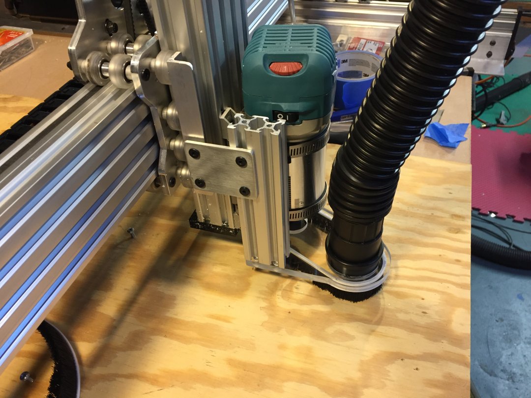

    got my Dust shoe/boot.. thingy.. done tonight! more pics going into the build page..

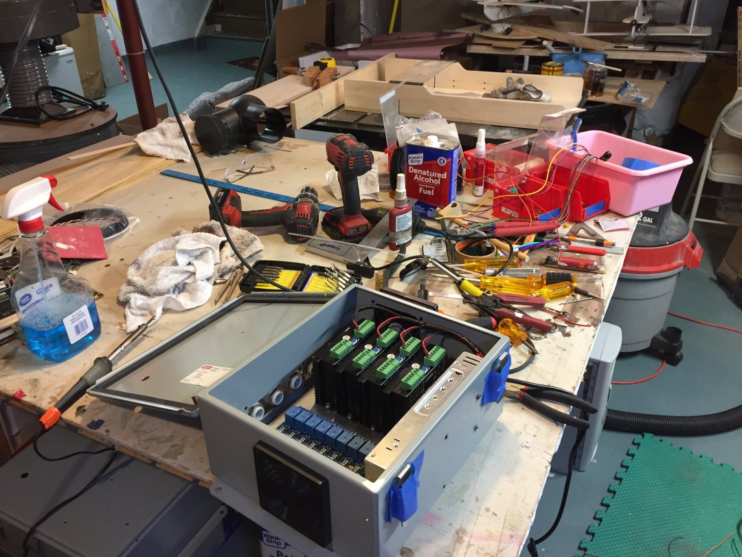

  10. EfrainLenisMaturano
    Mar 8, 2017
    sorry for the confuse, I need the drive electronic box for the nema 23, please.
  11. Gary Caruso
    May 19, 2016
    1,204
    536
    12x10x5" is the electronics, no problem
    EfrainLenisMaturano likes this.
