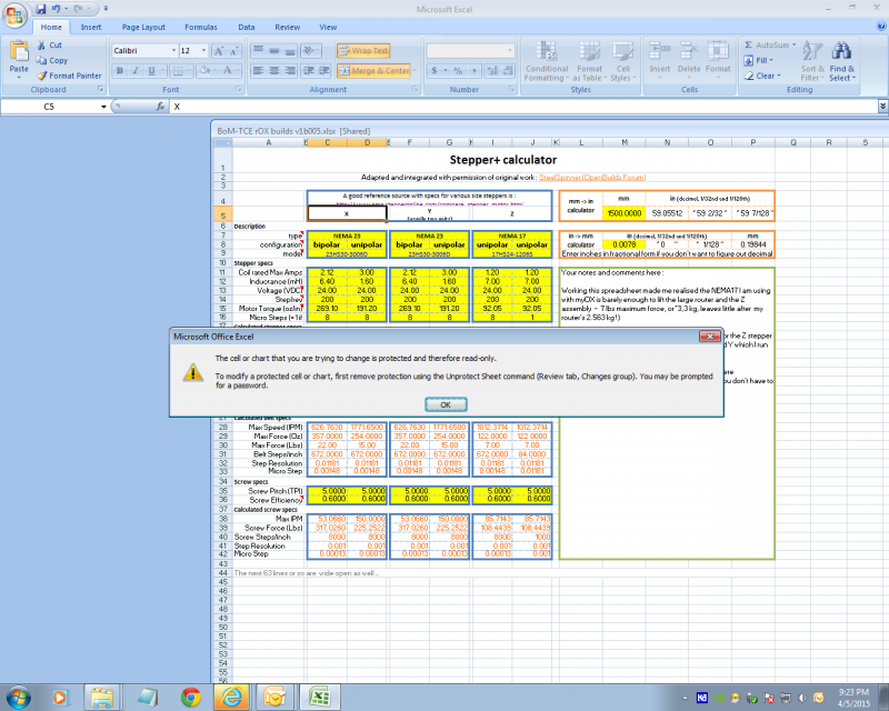

  5. Dale Mahan
    Mar 29, 2015
    13
    Can't seem to get the OXCalculator working. When I try to put an X length in the spreadsheet, I get an error message saying the cell is locked. When I try to unlock, I am asked for a password that I don't know. Please see the attachment OXCalc.png
  6. Serge E.
    Serge E. Journeyman
    May 6, 2014
    730
    252
    Now I see you are having the problem on the second tab/worksheet, the one for the stepper related calculations. I was looking for the problem on the main tab (the OXcalculator itself). If you look carefully at the Stepper+ calculator worksheet (the one shown in your screen capture), the X, Y and Z cells are column titles ... no data is required here. Data goes in the yellow'ed cells based on the spec sheet(s) for the stepper(s) you are using or planning to use. The default values are those for the steppers I am using, as shown in the reference cells (part numbers acting as links to web pages over at www.omc-stepperonline.com).
    Maybe I saved it with this worksheet open by default ? My bad if I did, sorry. I'll reword the 'description' cell to remind users to go to the other worksheet ...
    Check at the bottom (in Excel at least). There should be two tabs. One names OXcalculator (if memory serves me right - I am at work right now). It is not visible in your screen capture as you probably have to adjust the window size. Click on that tab and you will be at the OXcalculator worksheet page where you CAN enter the X, Y and Z dimensions of your OX to get a BoM worked out automagically for you. You will need to tweak the pricing and such to match your sources (I'll be updating default OBPS pricing).
    Sorry for the confusion.
  7. jnutt
    jnutt New
    Apr 15, 2015
    I'm having same issue as Dale Mahan. There is no way to get to the first sheet. Is anyon else having this issue? Was there a solution?
    Thank!
  8. Serge E.
    Serge E. Journeyman
    May 6, 2014
    730
    252
    This seems related to the screen resolution I have and that of the few who are having problems seeing what I see. You should be able to 'fix' that by forcing your Excel to redraw its screen. You should be able to flip between 'maximized' and 'windowed' to get Excel to consider your monitor's resolution/size.
    All I did on the protection/restriction is make it less restrictive and suddenly a few are reporting the inability to reach areas of it.
    I'll give it a look at work tomorrow with different machines (different resoluiton). I'm running an older MacBook 13" at... 1280 x 800. What is your screen set at, out of curiosity ?
  9. Serge E.
    Serge E. Journeyman
    May 6, 2014
    730
    252
    You could also just use the good old shortcut keys : CTRL+PageUp and CTRL+PageDown to switch between worksheets. The first goest left to right while the other goes the other way. The OXcalculator tab/worksheet is the leftmost while the Stepper+ is 2nd ... there should only be these two worksheets/tabs. I forget if Excel round robbins once at the far left or far right. Here's one of many list of shortcut keys which were still good in Excel 2010 :
    As for the resolution 'bug', :oops:, I'll be a monkey's uncle ! Turns out I had somehow blocked the "structure" ! Thus unable to resize or do much of anything on the second worksheet (Stepper+) although it was fine on the first, if one could get to it. Otherwise, the protection needs to be done one worksheet at time ... I must of tried a shortcut or some other stupid late night move. :oops: :banghead: :oops:
    The update will be up in a few minutes ...
