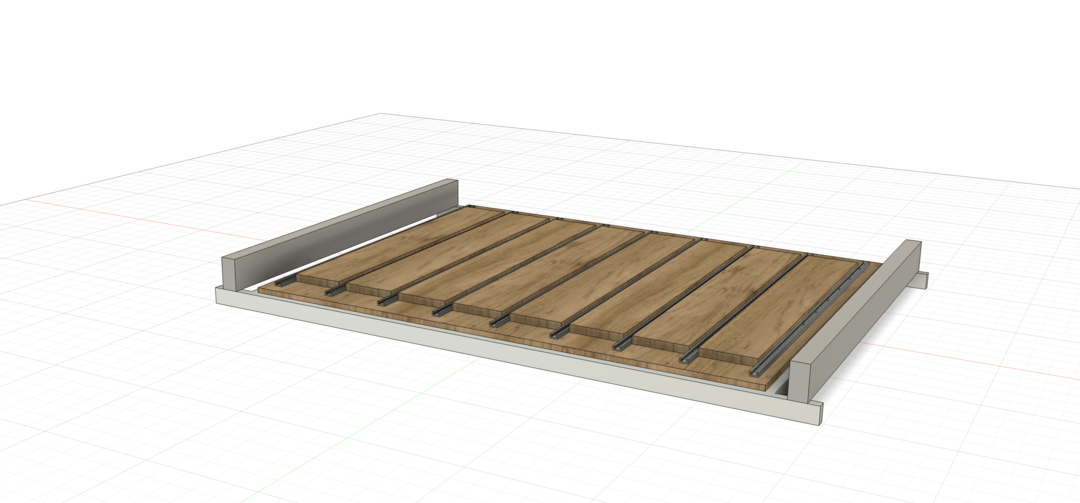

    Good afternoon, everyone.
    Doing some planning before ordering a LEAD machine. I currently have a small CNC (Next Wave Piranha), so I have some experience and have learned a few pitfalls to avoid in planning for the next one. But I’d like input from folks who have experience building larger ones like the LEAD machines. So I may put up a few posts like this one asking for input on various aspects.
    For the record, I’ve watched the entire build video multiple times, and I’ve read the wiki…all of it. Matt does a great job on the build video.
    This post concerns the base structure for a LEAD 1510 (15 in the X-axis, 10 in the Y-axis). I don’t like the idea of having to lift the whole machine and get underneath to get access to the spoil board attachment. So this is my thought about configuring to attach it from above instead of from below. I’ll try to include a couple illustrations with this post.
    The idea is to attach some wooden strips on each side of the Y-oriented 20x40 V-slot, using drop-in tee nuts and M5x40mm screws. Then bridge between those with more wooden strips oriented in the X-direction. Tops of the wooden strips flush with tops of the 2040 V-slot.
    This will allow me to assemble all the V-slot extrusions for the base, then add the wooden strips, then lay an MDF spoil board on top of that and screw it down to the wooden strips from the top. (I do plan to add a sacrificial spoil board on top of that, so the screws will not be in the way of any bits. More on that in a later post possibly.). At any later time, I could remove the spoil board without lifting the machine, and could even remove the wooden strips, if desired.
    Additionally, with this much extra structure underneath, I feel like I could get away with 1/4 inch MDF for the base spoil board, rather than 1/2 inch. That would gain me 1/4 inch in Z-capacity.
    Any comments, criticisms, suggestions?
    Thx, rink.

    Most folks install the standard spoilboard as-designed, and then a smaller, surfaced, sacrificial (eg 1/4" MFD) spoilboard on top of that. The big board provides rigidity, the sacrificial board takes the beating. Sacrificial board screws down to the primary using wood screws, composite nails, etc
    Also check out T-Rail T-Track 500mm
  3. Giarc
    3,062
    1,716
    I did something similar to add additional supports. I cut particle board scraps roughly the width of the 2040, mounted those pieces to the 2040, then used a flush cut bit in the router table to trim it down to the size of the 2040.

    Yes, Christian James, almost exactly like that.
    See illustration below. My plan is to put t-track on top of the base spoil board. Then put strips of MDF between those.
    It looks like you’ve milled channels in the base spoil board, then installed MDF strips over that. Is that correct? And is your base spoil board thicker than 1/2 inch and one piece instead of three sections? Are you using any actual t-track, or do those channels and overlapping strips serve that purpose?

    Yes, what you're planning is essentially the same thing and probably easier. I seem to remember having sourcing problems for T-track, hence doing without it. My base board is quite thick - about an inch or so. The reason for that is to not compromise the board strength after milling the slots. The baseboard of course adds to the structural integrity of the frame and yes, it is one piece covering the entire frame. As far as the top {spoilboard} is concerned, I believe I used a whole sheet and just milled the gaps which created the slots and the 5 separate boards. All the milling and drilling etc was referenced form the same zero position. The milled base slots and the machined board gaps create the effective T slots - no other parts used.
    Just a reminder....make sure the base board is surfaced before you fit the T-slot extrusions and the spoil boards

    After thinking through several options and with good feedback in this thread…I think I’ll install the 1/2 inch MDF baseboard as OB has designed (but in one big piece, not three) and bore some holes in it for several threaded inserts. Then top that with t-track and 3/4 inch MDF spoil board strips. Counterbore the 3/4 inch spoil board strips and use nylon hex bolts to attach them to the 1/2 inch base board threaded inserts. Then bore holes in the 3/4 inch spoil board strips and drive in some threaded inserts for additional work holding. That should accomplish everything I want, give me lots of flexibility, and easy to replace if necessary. Maybe I’ll shoot a video of my build process.

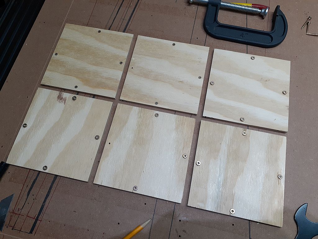

    I am not going to read more, just going to tell you what I experienced.
    I spent a lot of time sourcing, then drilling for and fitting, blind nuts. Never used them, in fact that spoilboard is now not even on the machine.
    Now mostly use tape and superglue, but now and then, like the current job, cutting hexagons out of 38 squares of plywood (4 hex per sqaure), I feel tape would be much more work than needed, so I have drilled the blanks, and drilled the spoilboard, and fitted woodscrews in the waste parts.
    This allows me to use 6 fixed offsets, G54 through G59, since I had the machine drill the spoilboard at the correct offsets, each piece of plywood will screw down in the right place so that the hexes are cut at the 6 offsets correctly. No carefully alignment of tape for each part etc.
    as you can see, there are other holes, and other markings, on the spoilboard. I view the spoilboard as a tool, a disposable tool, and when it gets too 'used' I will replace it, I have spare MDF for that purpose.
    Once you fit those bits of T-track, you will grieve over every scratch on the spoilboard (-:

    First I positioned and held down the bottom left panel, and setZero for G54. Ran the drill program to drill the piece of wood and about 0.5mm into the spoilboard, just a mark.
    That first piece of plywood is a template for drilling all the rest, I can clamp 3 pieces to it and drill all 4 holes with a battery drill much faster than I can fasten parts to the machine, there are 38 to drill and cut (with option for more later).
    Then to set up the G55 through G59 offsets I decided on a 10mm spacing and issued commands as follows
    G54
    G0 X160 ; move right 160mm
    G55
    setZeroXY
    G0 X160 ; move right again
    G56
    setZeroXY
    ; move up to next row
    G0 Y160
    G57
    SetZeroXY
    G0 X-160 ; move left 160mm
    G58
    setZeroXY
    G0 X-160 ; left again
    G59
    setZeroXY
    Now all 6 WCS systems are set relative to the first one. This is not absolutely necessary, the actual position of each one could vary quite a bit and it would all still work (the reason for WCS offsets existing!) but would be quite a job to repeat.
    Since I wrote down the G53 coordinates of the first one I can easily repeat the setup. G53 to the offsets, setZero, then repeat above for the other offsets. Homing wins again!
    Having set all 6 WCS systems I ran the drill program at each one to get marks for the screw positions on the spoilboard then manually drilled each one for the screws.
    In the image you can see the screws are not all the same size so the pilot holes are not all the same size either, that is why I did not drill to depth with the 3.2mm drill that fits the collet, it would be too big for all the screws.
    Having screwed down all 6 squares I probed Z on the top center of each one, I know the spoilboard is not flat, we have had 2 weeks of rain and nothing is flat anymore, when it dries out it will go back to 'more flat' (-:
    Meanwhile I can probe the 6 WCS's, and its not critical on this job anyway, I am leaving 1mm at the bottom of the cut which will be cleared on the router table with a guided bit.
    This is less of a pain than cleaning off tabs, IMHO.
    Then I edited the cut program which comes off the CAM in the form
    header
    G54
    cut 4 hexagons
    footer
    and made it cut 6 times
    header
    G54
    cut 4 hexagons
    G55
    cut 4 hexagons
    G56
    cut 4 hexagons
    G57
    cut 4 hexagons
    G58
    cut 4 hexagons
    G59
    cut 4 hexagons
    footer
    The other option is to tape the squares down, probe each one every time (no way I can tape them in exactly the same place) , then cut, repeat.
    Bit of a pain since the hexagons have 0.5mm of spare space on the sides of the squares so alignment is kinda critical (biggest 4 hexagons I can fit on the 150x150mm squares with a 6mm cutter)
    Yes, the hexagons are for some sort of board game. Yes, larger raw material would make more sense, customer supplied this.
    another method would be to fasten fences at left and bottom (just screwed to the spoilboard), snug 1 square against the fences, apply at least 2 clamps on the top and right edges, cut, repeat
    (first cut probably has to be adjusted to cut the fences correctly too).
    This would be fine for 2 or 3 parts, but far too much work for 38 parts.
    As you can see, some cut paths are outside the raw material (orange lines). Designed and Gcode generated from Sketchup 2017.
    John explains it quite well too.
