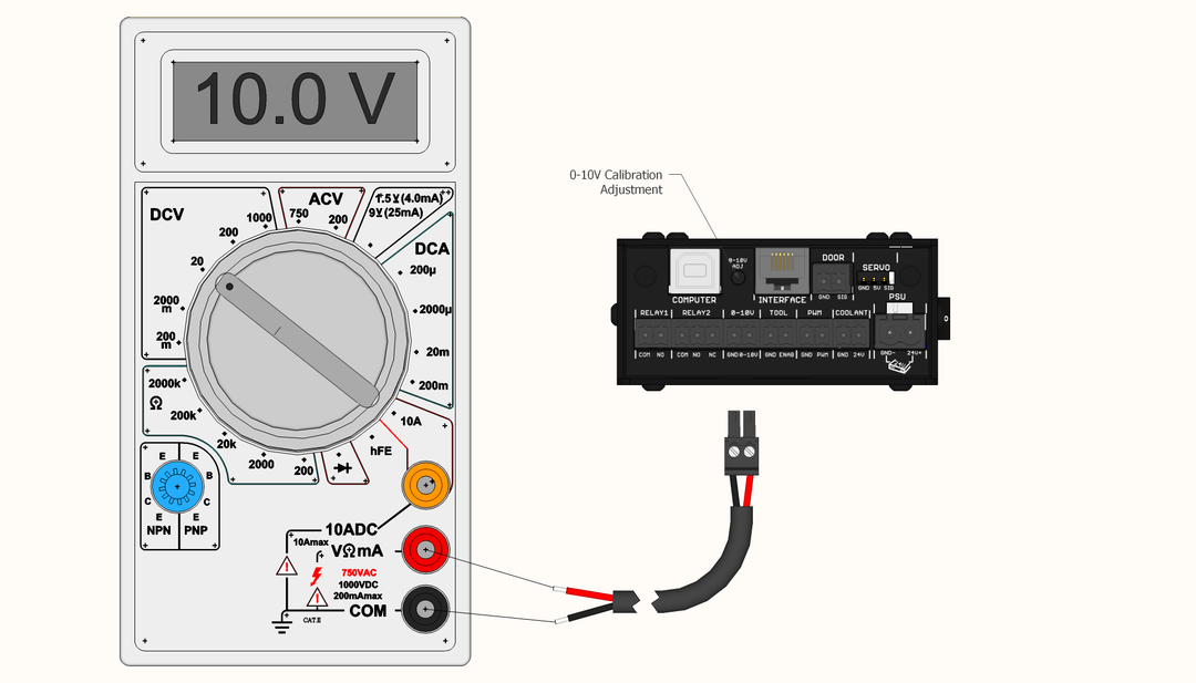

That's not the tool head pins. But the 0-10v output. Seperate plugs. Be specific about which you are working with
Refer to docs.openbuilds.com and do things right. Random "lets try the nonstandard thing" may lead to a damaged blackbox. The other outputs are all documented for their respective uses. 1) 24v PSU on? 2) measure and adjust 0-10v output exactly as described in the docs 3) if multimeter says you get 10v with M3Sxxx where xxx = value of $30 then BlackBox is set up 4) only then do you approach the VFD - otherwise it becomes a blame game. Seeing the multimeter result in (3) as OK, then if you have issues you know its more likely VFD parameters
I do get 10v but not in tool pins… only getting 3.1 -3.2v nothing changes when m3sxxxx xxx I have done vfd setup as per instructions on ob… maybe ive missed a setting in ob?
ONLY the 0-10 output should show (as labelled) up to 10V The other pins (Enable, PWM, etc) are 3.3v logic pins. They have OTHER uses (like Diode laser on PWM, IOT relays on Enable, etc). Not to be used for a VFD! (imagine how quick you'll fry the MCU by hooking a VFD terminal with a 24v pull up to a 3.3v logic pin! Please stop doing that, warranty won't be applicable) If you measure 10v at the 0-10v pin with M3S<max rpm> then no, you did not, and we are working fine. We cannot get too involved in VFD itself as we don't supply that, but refer your manual, and cross reference the Write ups linked to in the docs. Setup input terminals, tell them to expect 0-10v, remember your DCM/FOR jumper wire (labels differ between brands) to "arm" the VFD, configure Min Freq properly so lower than minimum RPM speeds doesn't turn it on etc.
I didnt hook up the vfd yet… like ur manual says …. Till i was sure it puts out 10v…. Ur manual states that vfd goes to tool pins…. How is that 10v? ive done everything what ur manual said…. And stil not sure if i should even attempt to hook up vfd cuz u are scaring me… ♂️♂️♂️
The picture in the docs shows exactly what to do: Make sure to look at the Blackbox X32 docs. Not the Old 4X's docs. The 4X had a single 4 pin Toolhead plug. The community contributed writeups were probably all BlackBox 4X but of course adapt to the new plug (same signal, just seperate plug now). We don't document VFDs as there are too many and we don't sell them at this time
So confirm, you are getting 10v out of THAT connector (yes or no?) the plug in the picture labelled 0-10v - when setting spindle speed to 100% (use the Tool On menu in CONTROL if in doubt on commands) Repeat test with 50% (5v+- etc) for example too to see how it works. Multimeter only
