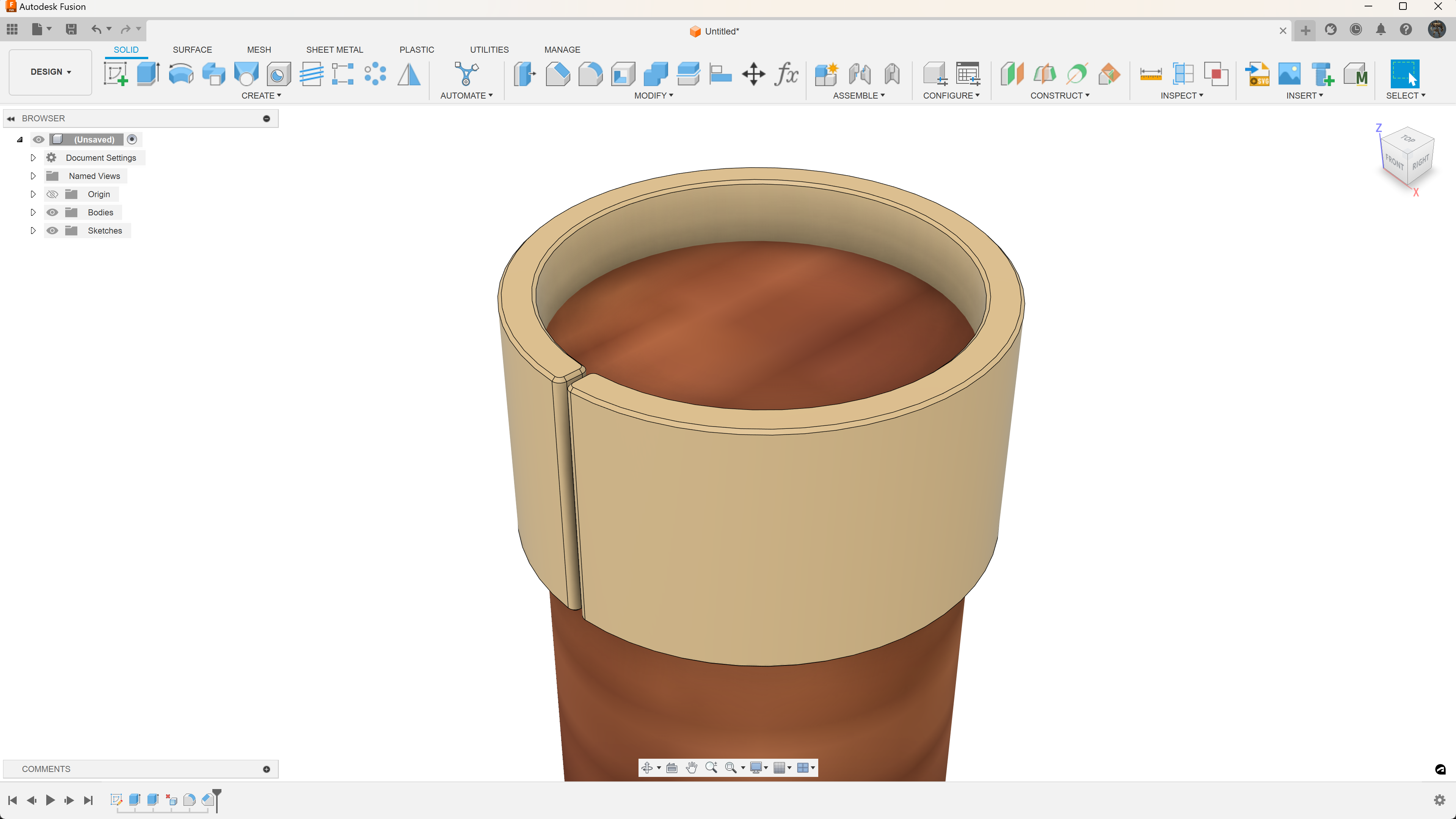

    I for one have solved the lack of an Outside Diameter Probing by 3D Printing myself a slightly undersized ( to apply tension ) C-Clip I can temporarily clamp around whatever Round Stock I need to find the center on and perform an Inside Probe on the C-Clip instead.
