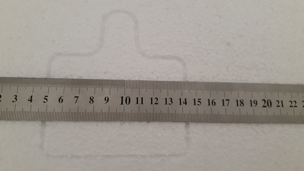

  27. David the swarfer
    3,439
    1,909
    if it is missing steps then the end of the cut would not match the beginning, that is not happening.
    you say you rotated the part 90 degrees and got the same (mis)shape?
    this is my test cut in some polystyrene with a 1/8" bit. In bCNC I deleted all the large parts (dont fit my machine!) and moved the origin, then searchnreplaced the feeds with 'foam safe much faster feeds'.
    SeanD likes this.

    If you draw a line down the middle of that cut is it symmetrical on both sides? Not 100% sure but I think maybe the photo is just hard to see if it’s a mirror or if the right hand side is slumping.
    Yeah I rotated the project 90 degrees and reprocess and cut again and it makes the same errors in the same spot and is identical.
    How do I reset everything back to scratch in my blackbox? Figure it probably won’t help but might be worth doing. I assume I just backup my settings, and do something to the EEPROM?
  29. David the swarfer
    3,439
    1,909
    utterly symmetrical in all directions
