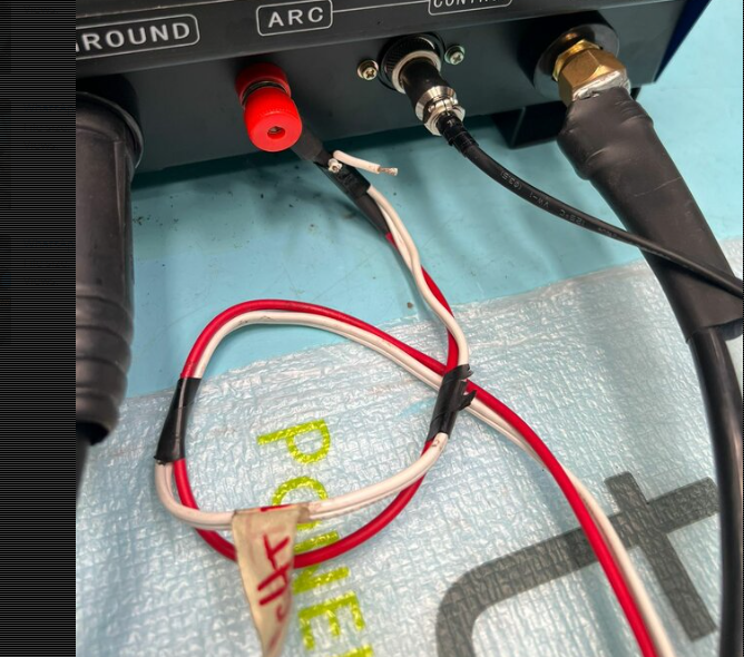

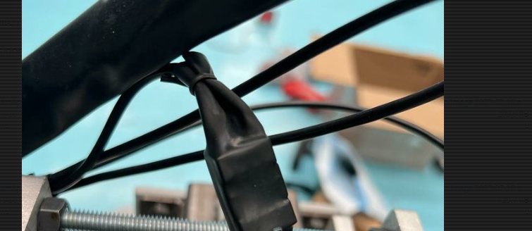

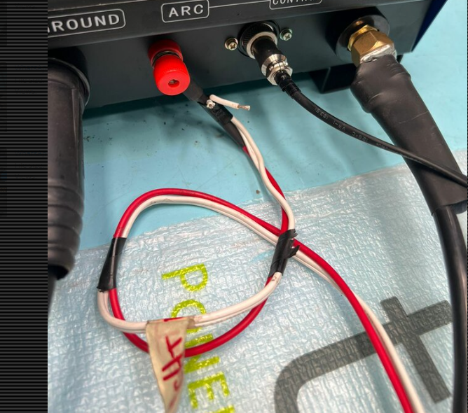

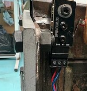

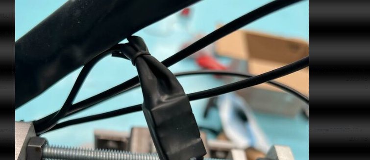

    These are the pictures of the motors, sensors and plasma control connector, however the plasma is not connected to the blackbox relay right now.
    The sensor that has a green box is the Z-axis sensor, however we do not have a Z motion yet.
    We have a cable from the plasma machine with a label "nozzle switch" that we do not have connected as shown in one of the pictures.
    Watching a configuration video, we were unable to move the axes home because it shows alarm 9.

    Other thoughts:
    - Can't confirm or deny if its a blowback inverter from the pics. Take apart the nozzle and see if it has a movable / spring loaded electrode
    - Does all the switches have their rubber backers? (Metal frame, check that pins on switches cannot touch metal. Aluminum is anodized (nonconductive) so you may need to add more insulation so the pins on back of switches cannot short to nearby metal when bumped
    - The cut wiring near the Arc input - what are those cut ends. Unterminated wiring are culprits for EMI - even induced interference (running near high voltage cabling elsewhere, unconnected ends effectively become antennas. Unused wiring removed or earthed)
    - Can this bolt reach the topside of PCB? Hard guess from picture angle, but we are looking for something that may be shorting, and a hard bump on switch looks like it may move back and hit that bolt/nut and some SMD components can short
    - Wire management - no limits wiring etc near motor/high voltage wiring? Looks like a couple wires cable tied there, check for crosstalk and seperate signal wiring

    It seems that we do have a retractable nozzle, but what we do not know is if it is being used, since we believe that the cables that are not connected are for that function, we understand that these cables are activated with a relay since they have continuity between them. Possibly my plasma is working with high frequency and not with low frequency since those cables are in the air.
    Okay, we have isolated the solder pins as well, as they may have been making contact with each other.
