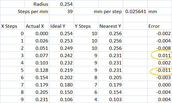

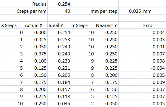

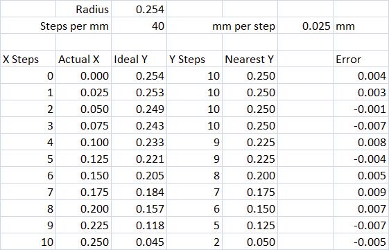

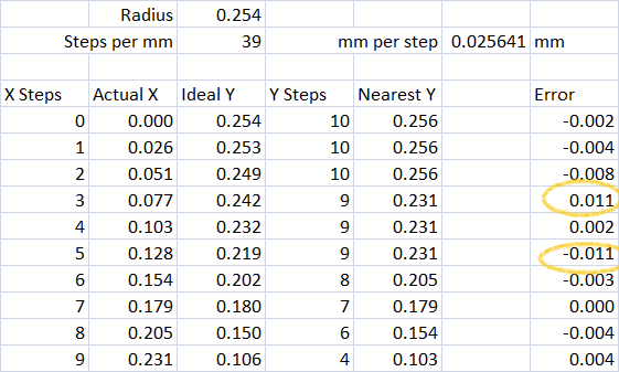

    I strongly suspect that you're running into accuracy limits within GRBL that are inherent in the move that the machine is being asked to make with the resolution of movement available.
    The basic issue is that the machine is being asked to move in an 0.25mm radius arc in steps of >0.025mm. The machine can only move in discrete steps. I don't know the detail of how GRBL calculates arcs, but assume that it uses the exact X moves, calculates the ideal Y position and then moves to the nearest step. (The Y steps count down, sorry.)
    Example with 40 steps /mm
    Example with 39 steps /mm
    It may be coincidental that the error exceeds 0.01mm as the steps per mm go from 40 to 39, but in any case, the calculation gets increasingly inaccurate which will likely trigger some sort of error within GRBL.
    You could try disabling smoothing for the toolpath within F360 (which tends to introduce arcs when it can) and/or chosing a larger lead-in radius (do you even need one for a plasma cutter?). Also, there is an option somewhere (in the POST?) regarding arcs and line segments - make sure this is set to encourage the use of line segments in the toolpath to take the arc calculation outside GRBL.
