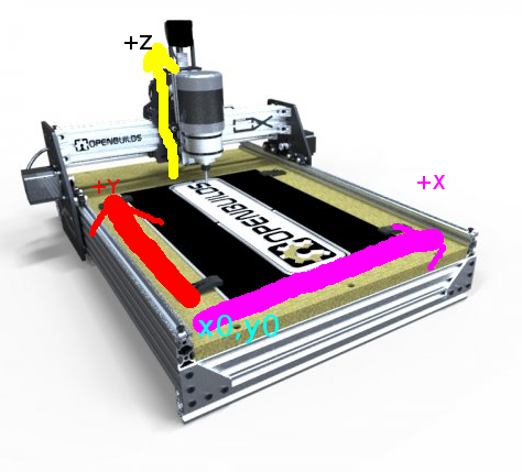

    New to OB, drawings come in the 3d window properly and simulate properly, however, everything is upside down and in reverse when my machine cuts?

    Go into grbl settings and change $3 to invert X and Y directions.

    Axis directions must be like this
    ie, the relevant axis moves in the + direction when you jog +
    actual X0 Y0 may vary depending on how you set up the homing.
