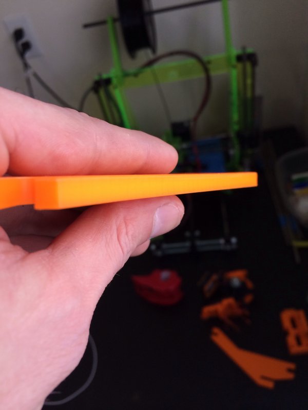

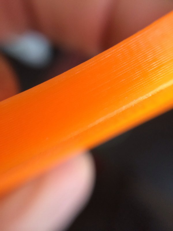

    I know that Robert has an iPhone... which could explain the picture quality :p But ribbing is inherent to 3D printing as it is a layering technique. You can have more or less depending on your settings, but it won't ever be perfect. I have to find a macro lens for my Nikon to show some close up pictures of the ribbing at different settings. Also, my printer isn't perfectly calibrated.
  6. Robert Hummel
    Robert Hummel Custom Builder
    Moderator
    Nov 14, 2013
    978
    717
    Here is a reg and macro pic, you will always have some sort of ribbing the trick is to get it to a min.
    This is .2 layer
    Mark Carew and Mopar32985 like this.

    $15 iPhone macro lens ;)

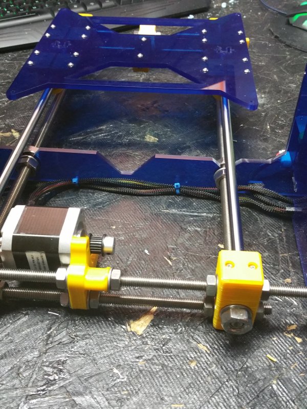

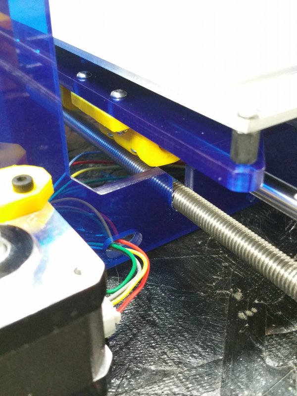

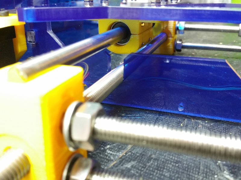

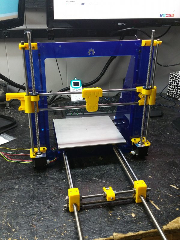

    Another quick guestion on the y axis the bearing blocks are hitting the acrylic frame any input. I just mocked it up really quick to test and it hits just a little. 20150411_173854.jpg 20150411_173847.jpg
  10. Robert Hummel
    Moderator
    Nov 14, 2013
    978
    717
    You have them backwards the screws face out with the frame you have ;)

    Thanks man i figured it was something small like that

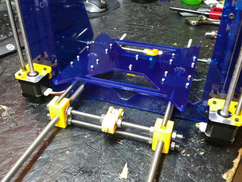

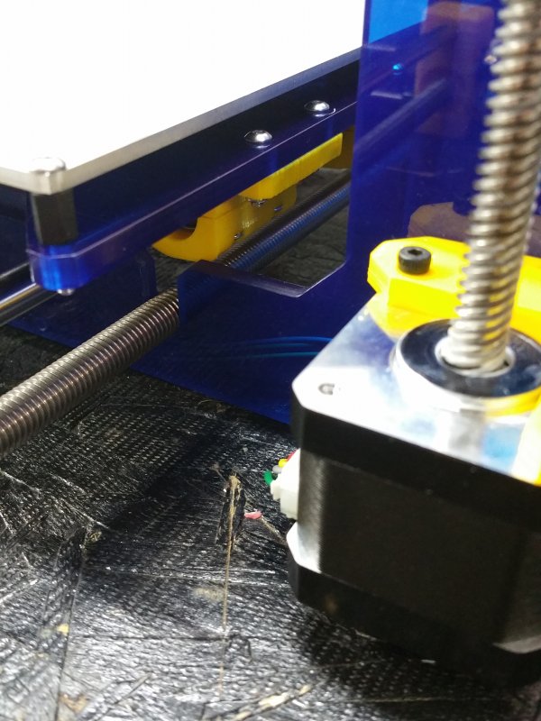

    Ok so i flipped the the y bearing blocks and im still having the same problem any advice 20150411_212351.jpg 20150411_212406.jpg 20150411_212423.jpg
  14. dddman
    dddman Journeyman
    Mar 2, 2014
    468
    187
    Do you have a file somewhere?

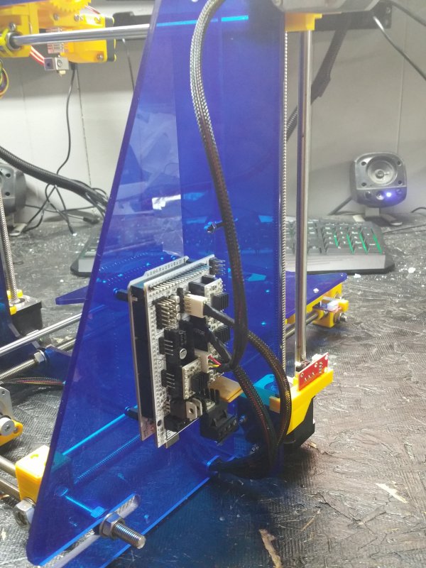

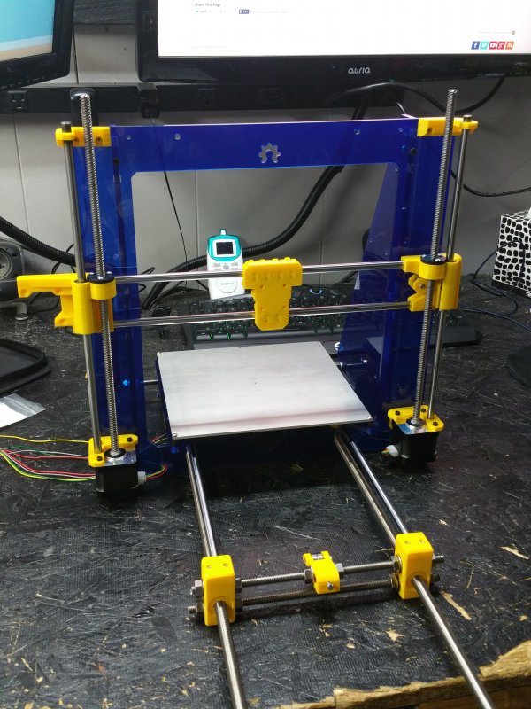

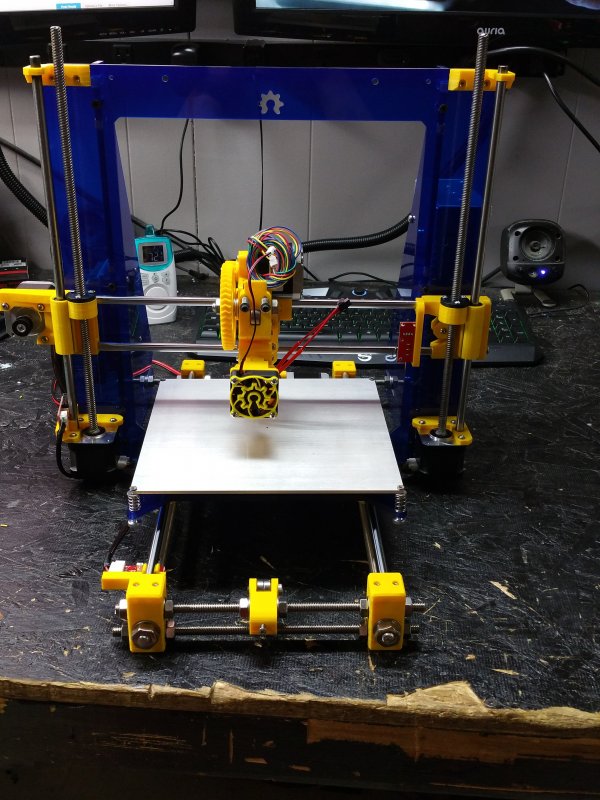

    Well made some good progress. Im trying to fight the urge to rush and make the wires clean. What are you guys using to route wires from extruder to ramps and keep it clean. Sorry for large pictures 20150412_141936.jpg 20150412_205453.jpg 20150412_205501.jpg 20150412_230511.jpg

    Mopar32985 likes this.

    So the same stuff im using. That gives it enough supportand keep it out of the way. I was also looking at the spiral cut plastice wire loom.

    Alright so all the electrical is done now just need to install the belts and upload the code to the ramps. Do you have a link or file of the code? its been a long time how do you upload the code again do you just upload in arduino software? Thanks really excited to get this going hopefully tonight or tomorrow night
  26. Robert Hummel
    Moderator
    Nov 14, 2013
    978
    717
    Yes you download Marlin and use the arduino software to change settings and flash to the ramps setup.

    Aright guys have the OBi3 moving but i cant get the endstops to work is there something i can change in code. Even if im in pronterface and hit home button it does nothing. I can move the axis when i use the arrow keys in pronterface but also does nothing when the endstops are hit. When i depress then the led light does light up. @Robert Hummel would it be easier to just get your file since mine is the same im also using smart controller
  30. Robert Hummel
    Moderator
    Nov 14, 2013
    978
    717
    Yeah will save May Marlin and upload a file for ya
