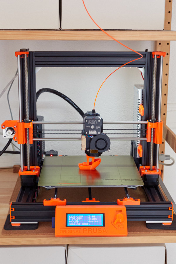

    I finished to mount the MK2.5 during the week-end and on the side of the Bear Upgrade everything was fine. However, I am having a weird issue where the extruder is skipping steps on the first purge line. I have asked on Prusa forum :
    Extruder is skipping steps on purge line
    If some of you have ideas let me know!
  13. xequtor
    xequtor New
    Jan 23, 2018
    44
    on the end of the purge will be more material pushed, could be low temp, filament problem or maybe extruder gears not tight enough
    #193 xequtor, Mar 20, 2018
  14. pek
    pek Journeyman
    Apr 17, 2017
    196
    130
    I tried to tight them less and more but got the same results
    I have disassembled the extruder and I found that the top PTFE tube was a slightly squished by a piece of plastic. I have cleaned the PTFE tube hole and double check the hole between PTFE and Bondtech pulley. Unfortunately this does not change anything.
    I removed the genuine E3D silicon cover, same result.
    Something else I could observed is that my bed seems to be badly leveled (front the front, on the left side the level is bigger than on the right side) and I could not correct it with the bed level correction menu... Firmware is still RC1 so maybe there are issue with the functionality.
    I am currently printing a Benchy to see if it is only a problem with the first layer / first purge line.
    Then I will take the road of the filament/low temp issue

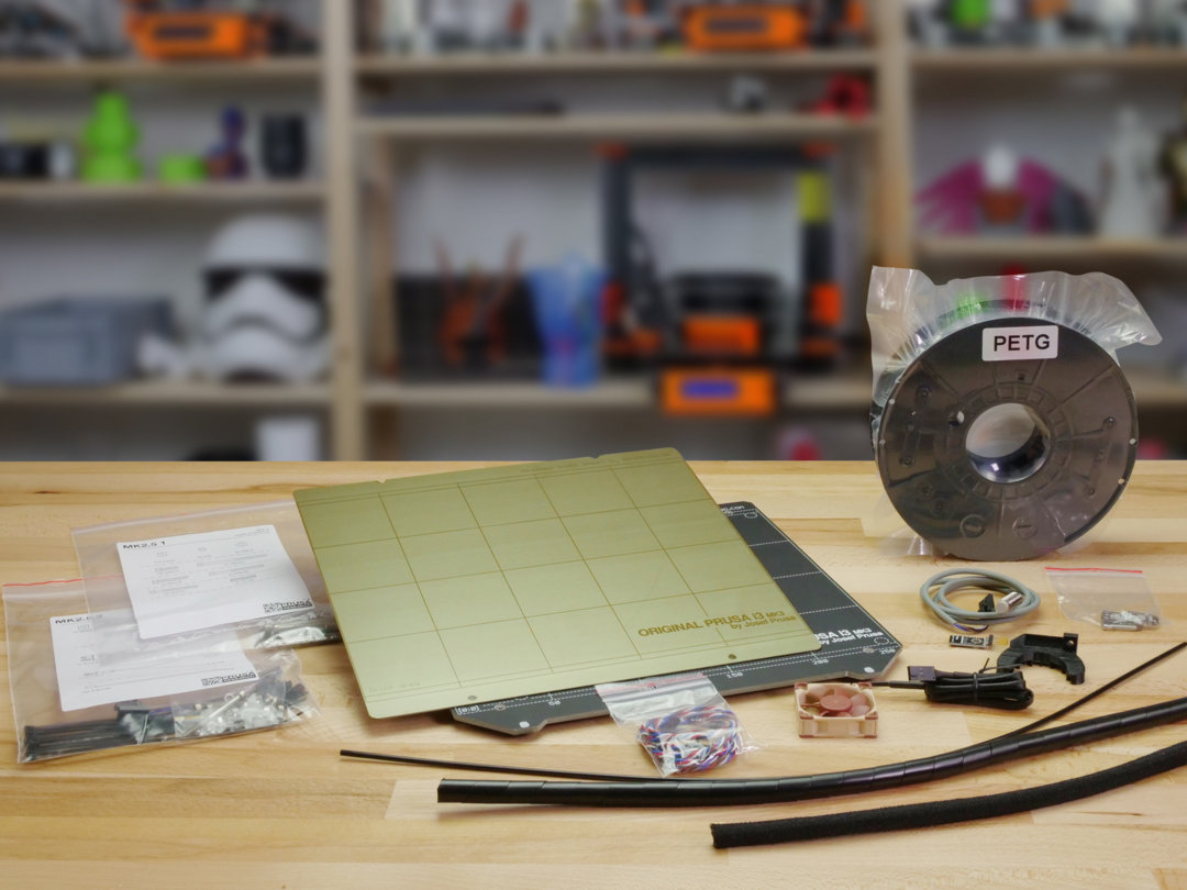

    do you have pictures what included in the MK2.5 upgrade? there is just description on Prusa site but no detailed pics, like if there are the distance rings between the Y alu carriage and hotbed.
    I want to place bigger order by Prusa (Filament, Einsy, etc ) and considering the MK2.5 upgrade for my Alu Ultimaker, still thinking what I want to do.
  16. pek
    pek Journeyman
    Apr 17, 2017
    196
    130
    For the distance ring, are speaking about the standoffs? Yes they are already mounted on the bed.
    Here is what you get with MK2.5 upgrade :

    Finally! Extruder issue solved! That was mainly the nozzle, I swapped for a new one! \o/
    I can work again on new parts / optional parts!

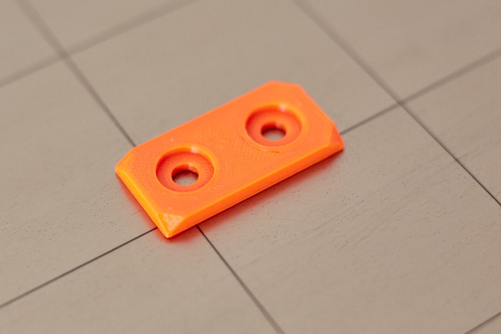

    I have done some update :
    - New printed parts to cover top of the Z axis. This part has some space in case a t-nuts is a bit longer on top and it saves print time and material. Can be used with self tapping screws or standard low profile screws
    - All BOM and manuals have been updated according to this new part
    - I now recommend an orientation for zip ties on Full Upgrade (they might touch the heated bed sleeves with MK2.5 and MK3)
    - Added zip ties reference to all BOM
    - Added recommended spare parts to all BOM
    - Added McMaster-Carr links for non-Openbuilds components

    I hope I'll get my V-Slot extrusion in next few days the the big part print action can start.
    the Z axis top cover, can this be integrated in the top Z rod mount? if not I would design (and I will :) ) it w/o need for screws, just insert in the extrusion, I think screw is overkill
